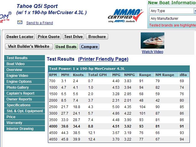

This test is a newer 19' runabout, but it will give you an idea what to expect.
My experience has been that going up 2" on prop pitch will give slightly better cruise economy but cost you a little acceleration and top speed if your boat is currently propped correctly to put it in it's optimum WOT (Wide Open Throttle) RPM range.

Actually"best mpg" on many boats Is usually around 4 to 8 mph. (displacement speed)the report comes close at 1,000,@ 4.7 mph.probably right on at about 1,200 I read about a 16ft bio diesel launch that approached 30 mpg at dislacement speed.
Best "practical" mpg is at or above planing speed.Many folks believe just planing when it can be signifigantly higher.Pretty tough to figure "best mpg" without mentioning gph.There are plenty of boaters that don't know they can measure gph and figure "best mpg" nor is it imeadiately obvious that simply boating at a low gph may not be the "best mpg"
