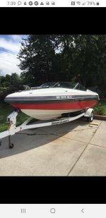

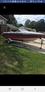

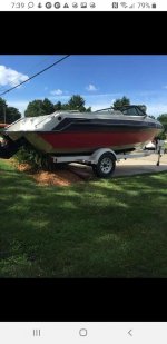

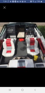

Hey all, I haven't ever posted in this section of the forum. I currently have an open bow 17.5" boat with a Merceruiser 470. However, my wife and I are wanting to bump up in size slightly and have a boat with a cuddy. After searching for over a month, I have my eyes set on a 1990 Rinker Captiva 206 cuddy with a 5.7 Mercruiser/Alpha 1 outdrive. Only 300 hours, and seems to be extremely well taken care of as the gelcoat and interior are in great shape. The current owner winterized it in October.
I am wanting to purchase a boat during winter time (I know, not ideal, but that is when you can get deals on nicer boats in the northeast US since the market is not "hot" during the winter). I realize I will not be able to do a full test run in the water, since it is extremely cold here in Ohio (10-30 degrees, supposed to be near 0 degrees this weekend!!). I also would hate to de-winterize the boat, purchase it, and then drive it over 5+ hours home in near-zero degree temps... At the very least I would do a compression test, test the ignition using a spark tester, and then maybe even turn it over for a few seconds and shut it right back down? Can that be done on a winterized boat? What about setting up a system that pulls antifreeze through muffs instead of water? Has anyone done that?
However, considering the condition of the boat, low hours, maintenance records, and the owner's demeanor, I am almost willing to take the chance. I feel there is no way I'd be willing to pay summer market pricing on a boat like this. He is asking $6,000 "or best offer". This is easily a $7-9k boat during the summer here.
I have attached pictures. I feel as though I can get the price down a little below $6k. Please let me know what yall think?

the only issues I have are as follows:
if the hull and foam are full of water, you wont know it until spring.
32 years is past a boats "prime" and "sell by" date. most boats are designed to last 15 years.
any fiberglass boat that old should be considered a project.
it may be a diamond in the rough, it may be a rotten and water-logged hull.
systems that pull anti-freeze thru the muffs will cause a cracked block unless you drain the water-jacket first. on a V8 boat, there are 5 plugs you pull and two hoses first to drain.
best advise I have, use the boat buying checklist. https://forums.iboats.com/threads/f...help-buying-a-boat-a-buyers-checklist.612841/

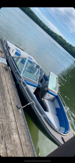

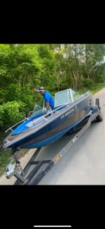

Yeah, I'm amazed at how well the 17-20' boat market is holding value. Even my 1986 Bomber Commander II (17.5 ft) with a 470 Mercruiser will probably sell for $3500-4000 at the beginning of summer around here.. its nuts.
We are only considering a cuddy boat as we may stay overnight in it a few times a year. Other than that, I totally agree that a bowrider is way more functional. Much easier to space out the folks that you're bringing along!

The boat looks in great shape from the pictures. It is risk/reward. If this guy selling seems like a good guy, he obviously took care of the boat then go for it. I have done the same thing this year but it is a partner and friend from work so I feel pretty comfortable.
