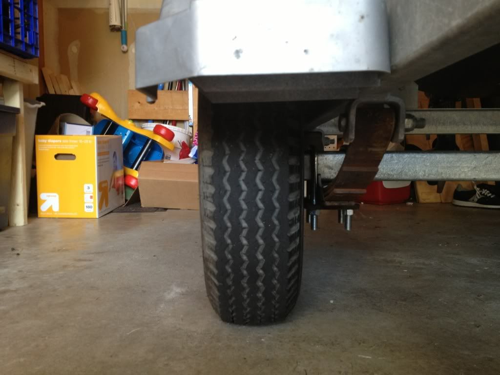

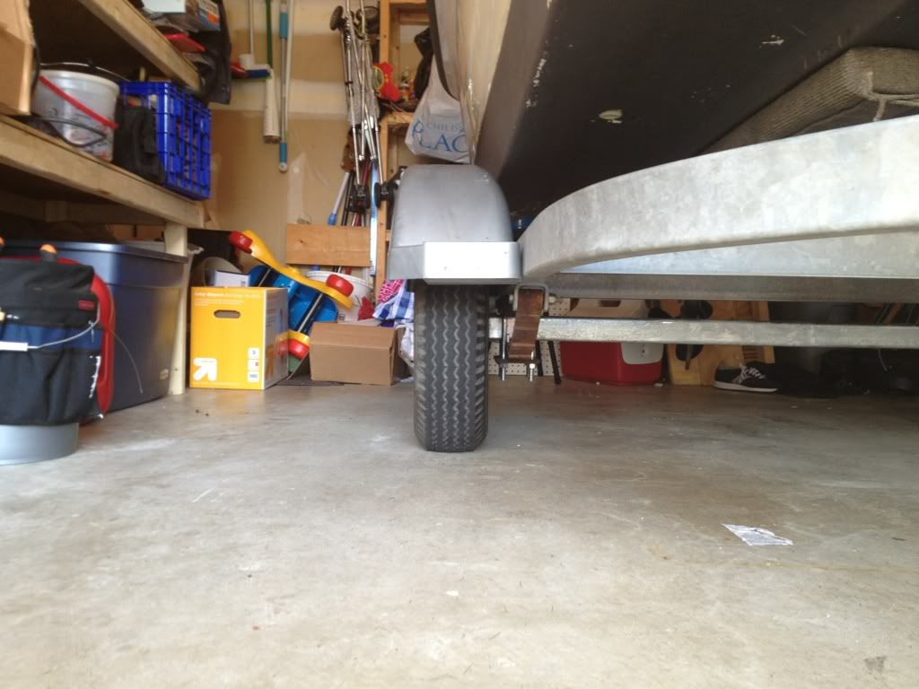

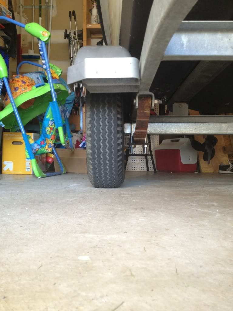

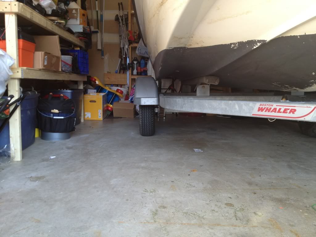

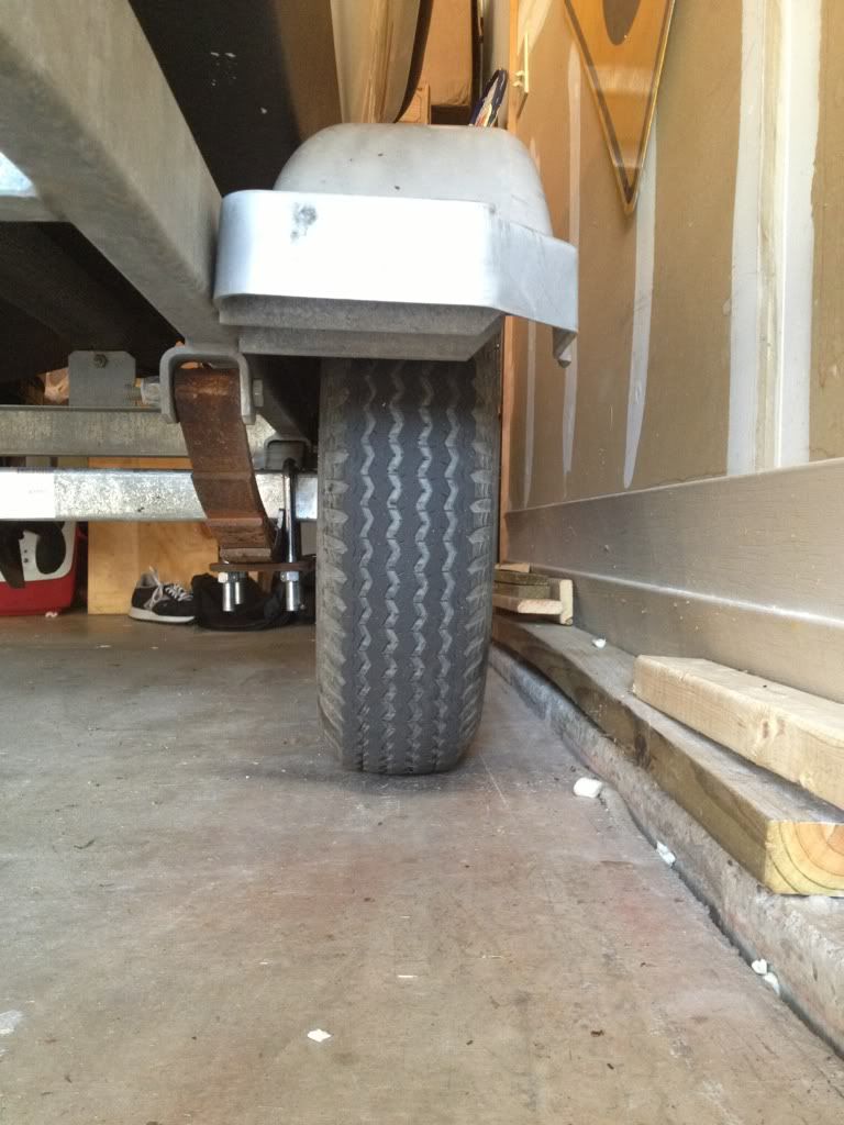

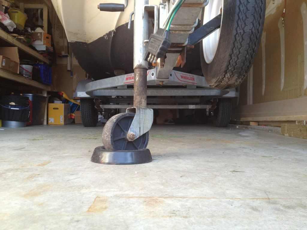

I just had my axle replaced on my 2005 karavan trailer that holds my 13' Boston whaler. Upon pick up I noticed that the tires appeared pitched outward at top of tire (positive camber). I questioned this and he said this is normal. I confirmed that the axle was installed with the correct position up as I did read that axles are built with some positive camber to counter the boats weight.
Does this look like excessive positive camber? If so, what should I do? Can I have anything done? Is it safe to tow? Is the only effect excessive wear? Any input will be appreciated.
Thanks
Jeff

Build shelves under the boat to hold about 40 cinder blocks. J/K. Looks like your boat just isn't heavy enough to put a load on the axle. Maybe need a lighter axle?

Toss an angle guage on there and report back. Doesn't seem like that much camber to me.

Your picture is just slightly off center, towards the center of the axle. Even without taking that into account, I don't see anything close to excessive.
Boat trailer tires very rarely wear out from actual use...

Axles come with various amounts of camber built in unloaded and level out when loaded. If you installed an axle that is rated a lot higher than your actaul load, this could be the reason for what you see.

First thanks everyone for your response. Turns out the axle is rated for 2000lbs, my boat weighs roughly 1500lbs boat, motor, gear, trailer. I don't think that's necessarily overkill, but could be causing the slight positive camber. One second I look at it, then I look at it again and think its not that bad.
Does everyone agree that it's not excessive and safe to tow? Or should I bring it back? My main concern is safety. On a side note, how often should you change your tires for age reasons? I do not have any gauge to measure the angle of the camber. Below is a few more pics

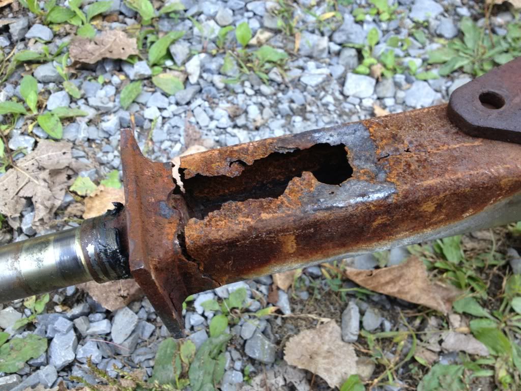

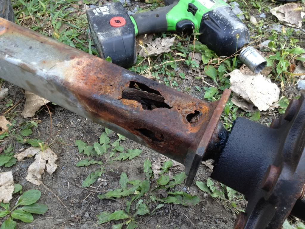

I believe it was also a 2x2 tube trailer which I believe makes it a 2k lb trailer as well. The old one rotted out where the drain holes were, really bad. I never noticed it before and am lucky it broke at launch and not on highway. I purchased it used 2 years ago, it was previously a saltwater boat.

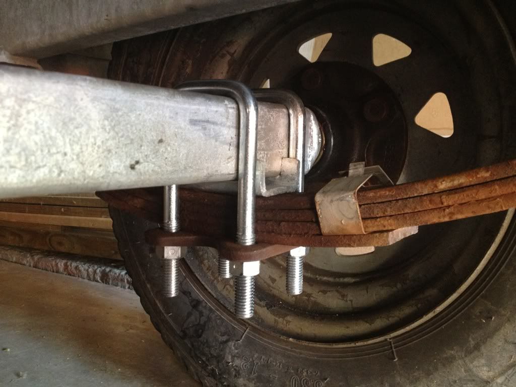

Side that snapped
Other side

The contact patch in the photo's of the new axle looks pretty good to me. Your tires are beginning to show the wear bars and should replaced soon.

We align a fair amount of trailers every year. Excessive camber will wear your tires. Your pictures don't appear to show excessive camber but getting a set of gauges on them will tell for sure. It is important to have cambers as close to equal side to side and to make sure toe is somewhere around 1/16" in. The other thing to have checked is to make sure axle is tracking with the centerline of the trailer. Not usually as noticeable on shorter trailers but important for even tire wear. Some automotive shops may still have equipment to align your trailer, with the advent of new alignment machines the ability to easily align a trailer may have been lost. You may find a truck repair shop might be a better bet as they may have the equipment used to align trailers pulled by semi trucks.
