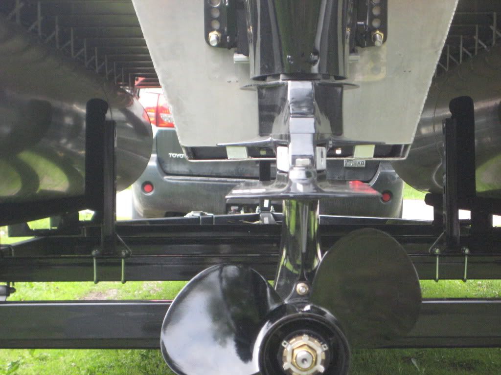

Ayuh,... The motor is mounted Too Low...
In your 1st picture, it appears to be Atleast 2" low,... Maybe More....
The Cav-plate should be Even with, or slightly above the bottom of the pod...

Re: Pontoon prop questions
Ouch, I don't see how I might raise the whole motor by myself. Any ideas on the best way to raise it? It weights 260 lbs.

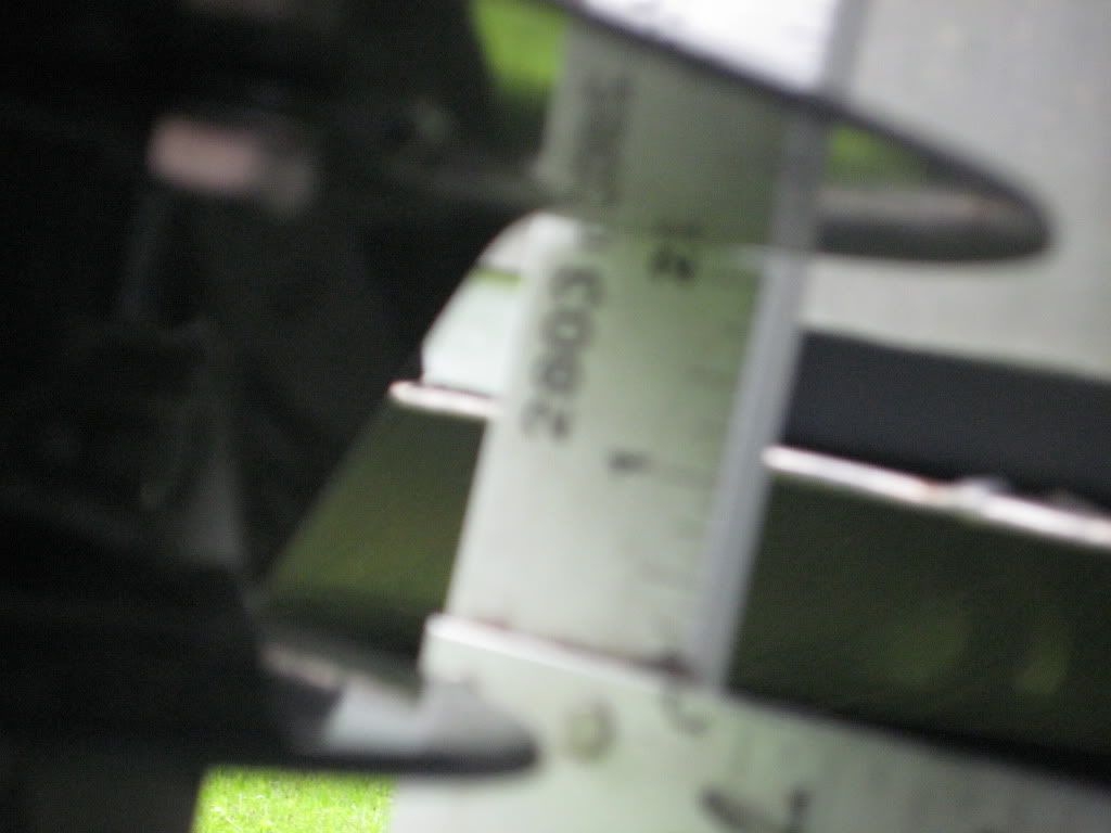

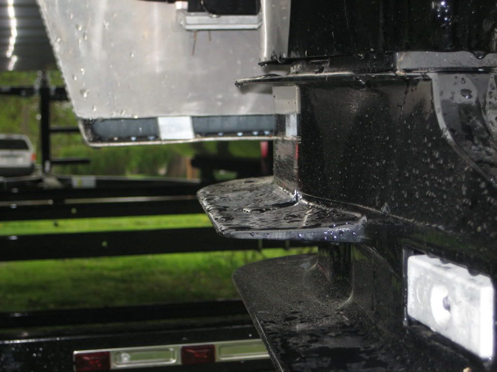

Another update.
I raised the motor as high as it would go. The ventilation plate is now 1 inch below the transom.
I was using the 14 x 11 cupped prop and got 20 mph and 5100 rpm @ WOT.
I plan on getting a 14 x 10 cupped prop and see what that does but I think I am going to be stuck @ 5300 rpm or so @ WOT.
Below transom.
Measured.
Sorry about the quality but it was hard to steady.
Am I correct in assuming that 5300 rpm @ Wot with a cupped 14 x 10 will be max rpm with this setup, the best I can expect out of this boat and motor.
I don't see what more I can do.

The motor needs to go up. A Bob's 4-n-1 manual will open up a world of possibilities.
