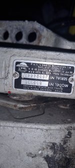

Hey guys
Well I have a 85hp johson 1980 according to the tag ,
question is would a 60-70's era 85hp evinrude/johnson piston fit or are they different in size as the 80s one is a good motor apart from the one piston showing signs of damage.
Are I able to switch out the piston from my other motor thats down in 2 cylinders (60-70s) or just go find a new piston set,any help is appreciated as I'd love to get it running again nicely
Cheers steve
Fortheloveofit
Feb 20, 2022
11
Forgot to add tag for the 80's,other motor hasn't got any visible tag (possible mount change according to previous owner)

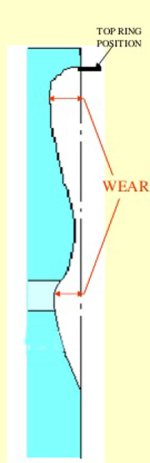

Are you going to re-ring the other 5 cylinders? Have you measured them for Wear? 2 Strokes wear differently than 4 Strokes, and need to be measured in more than just at the Top
