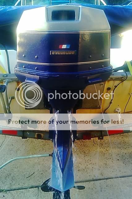

Well, for some reason, I can't get my pics to upload off my phone into my laptop, otherwise, this reply would've been replete with color photos!! Anywho....I stopped and bought the IR Temp "gun" (w/Laser!!!) at HF for $39.95 on sale, plus tax of course....fired up the motor and let it get nice and warm. Sorry, but I couldn't get this beast's lower unit into my big garbage can so it was muffs only. Back to the results: As soon as she started, there was a heavy stream of water coming from both exhaust relief ports, and then after warming up, the starboard side stopped (or slowed to a minute amount) and the port side was starting to slow. Temperature readings where 133-134 degrees on the Starboard side and 131-133 degrees on the Port side. Both sides began to cool a degree or two after what seemed like the T-stats opened so I can assume this means the Tstats are functioning? Since those temps weren't "high", is the consensus that I should just get back in the water and watch what happens?
As a reminder, it's about 3/4 of a mile out the channel at "No Wake". Do these older V4's tend to run hotter at idle? Maybe this had something to do with it? Because again, after I sat a while and let it cool, she purred like a kitten all the way back and it was the same trip coming as it was going, minus the over throttle and porpoising. (I'm also so happy to say she, again, fired right up as soon as I turned the key.....woohoo!!!)

Ha, figured out my "pic" issue;:D
As you can see, good steady stream from the tell tale. And, just because I'm proud of it, here's a pic of the boat itself (like that really helps)

Those head temps do not indicate an overheat at idle. Maybe just a little cool, actually. The water flow out of the exhaust relief ports looks normal. It is always possible your overheat was due to running over something-like a plastic bag. When that happens again, make sure you raise the engine for inspection. Those bags tend to hang on if the engine is in the down position and the boat is moving slightly forward. Time to take it out on the water, armed with your laster temp gun. V4's run warmer at idle-all the cooling water must go thru both stats. When you get up on plane, the pressure relief valves open, flooding the powerhead with additional cooling water. Your temps should go down somewhat when on plane.
