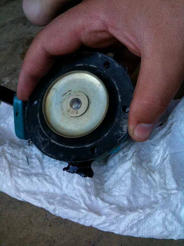

I took the old fuel pump off today & noticed there was a bit of gunk up the vent tube. It wasn't fluid like fresh gas, it was more like molasses. When I took the pump apart I noticed there was a bunch of this stuff under the diaphragm. It smells strongly of gas, but it's very thick & sticky... varnish?? Seemed like a lot of it. Or maybe a mixture of engine oil & gas?
Here's a picture of it seeping out that I took:
I'm actually hoping this is a sign of the fuel pump being bad so that the new one fixes my problem. I'm wondering if I should rebuild my old pump and sell it on eBay? Is it worth the cost of a rebuild kit? Should I just sell it as is and not bother rebuilding it?
For those who are curious, I took a few more pics of the pump all apart (sorry for the quality - they're all taken with my cell phone):
http://picasaweb.google.com/superbenk/FuelPump

I've never rebuilt that kind of fuel pump before or even though about rebuilding one... but I would think after looking at your pics that a little bit of oil coming out from under the diafram would be normal.
After all the mech arm on the thing is in an oil bath. My boat has the newer style but operates the same way with the arm riding on a cam providing the pumping action but one side of the diapram exposed to engine oil.
