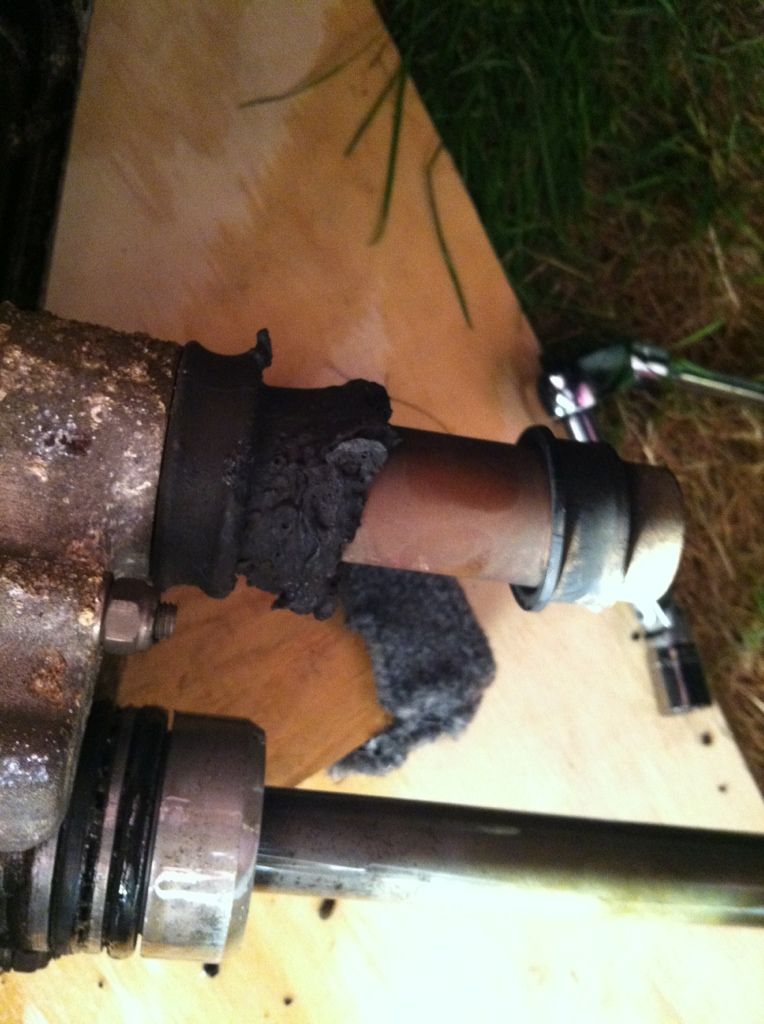

Here is what I found when I dropped the lower unit. The water pick up tube grommet is melted. But I pressure tested it and it doesn't leak.im Going to replace them and hopefully fixes my problem.

Fixed. Boat runs 150 all day. It was the intake tube grommet wasn't installed right by who ever took it apart before.
