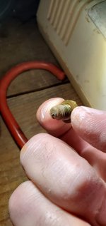

Time for an update! I apparently didn't clean the carb as well as I thought I did last time. After watching a few more YouTube videos on disassembly, cleaning and reassembly, I'm happy to say a good, thorough cleaning was all that it needed. For reference, I've attached a picture of one of the clogged needle seat. Thanks for all the suggestions and help!

Great when the op let's the rest know what the problem was. We all learn that way
