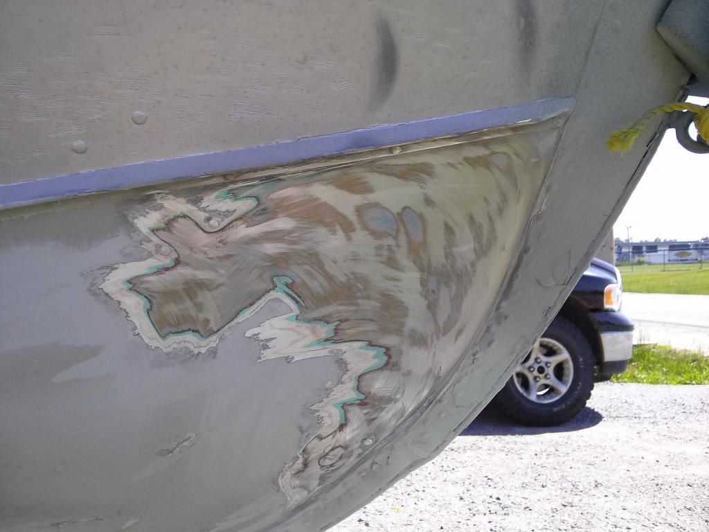

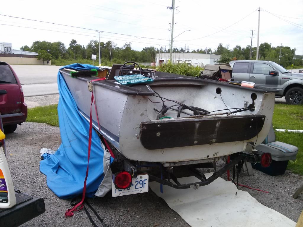

I have a 17 foot old aluminum that has leaking issues. Upon inspection, I notice that along the bottom middle, someone in the past has laid on what looks like bondo or something similar and there has been several layers of paint over that over the years. The bondo has a crack all along it length and is also leaking at the edges of it as well.
Rainwater that got in, leaking around edge of bondo filler.
Showing the crack in the bondo filler stuff all along the length of it, leaking from probably all kinds of spots under it.

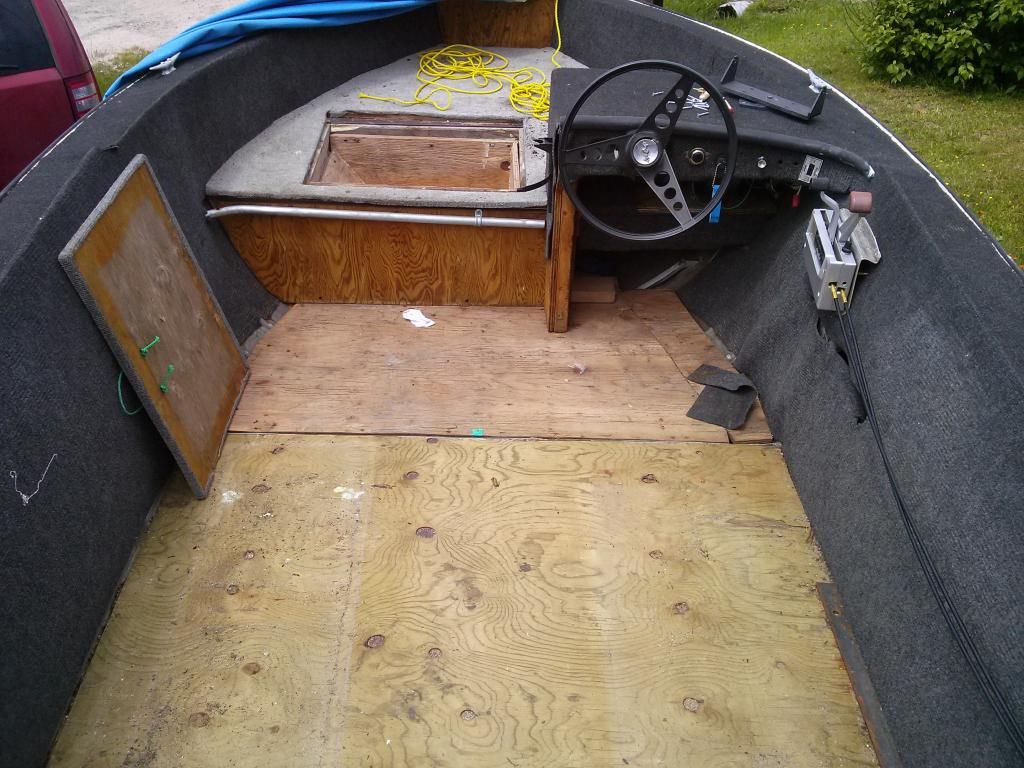

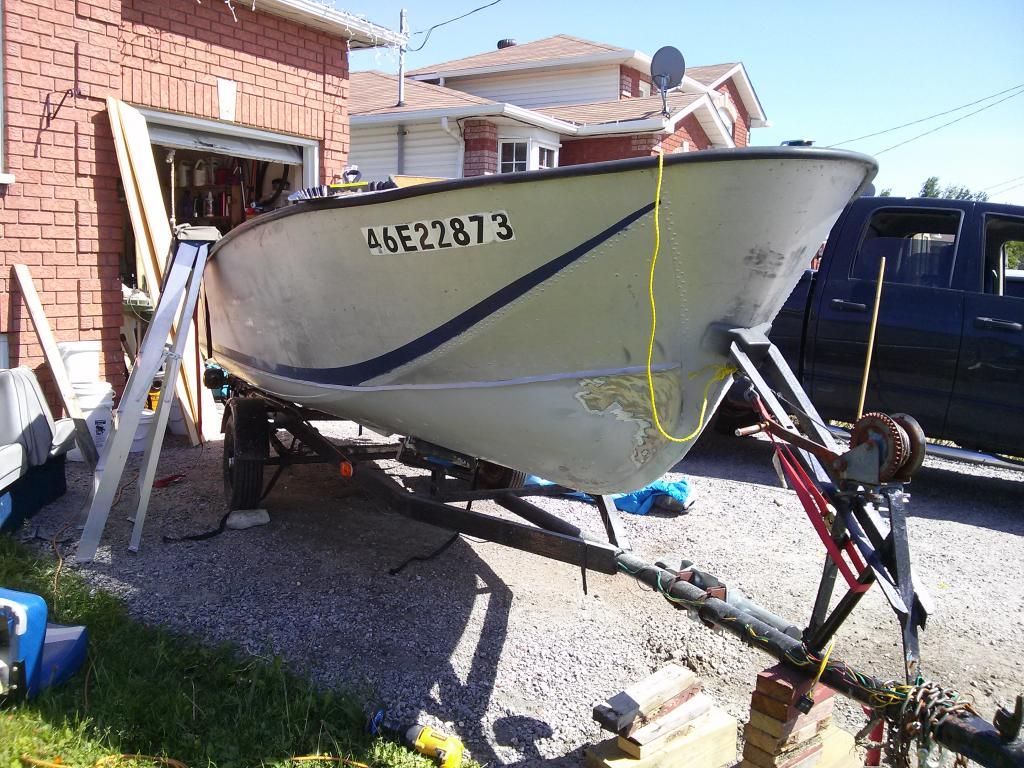

Gonna try and post some more pics I took today of boat and trailer, I have removed the motor and the interior seats and floor up to the dash area. Got myself a wire wheel for my electric drill and started on a patch at the bow just to see how its going to strip off...boy its not gonna be a fast job thats for sure! I switched to a sanding disc on the drill, for was taking forever to get thru all the layers of paint with the wire wheel. I think I will just use the wire for cleaning up around rivet heads etc.
Not sure what make the old girl is, pretty sure its not styled like any Starcraft tho.
I started a small section, can tell its gonna take a while!
Somebody can maybe let me know if the pics are showing up now.

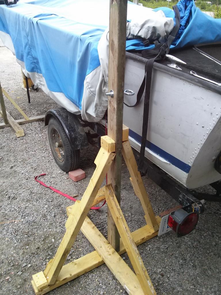

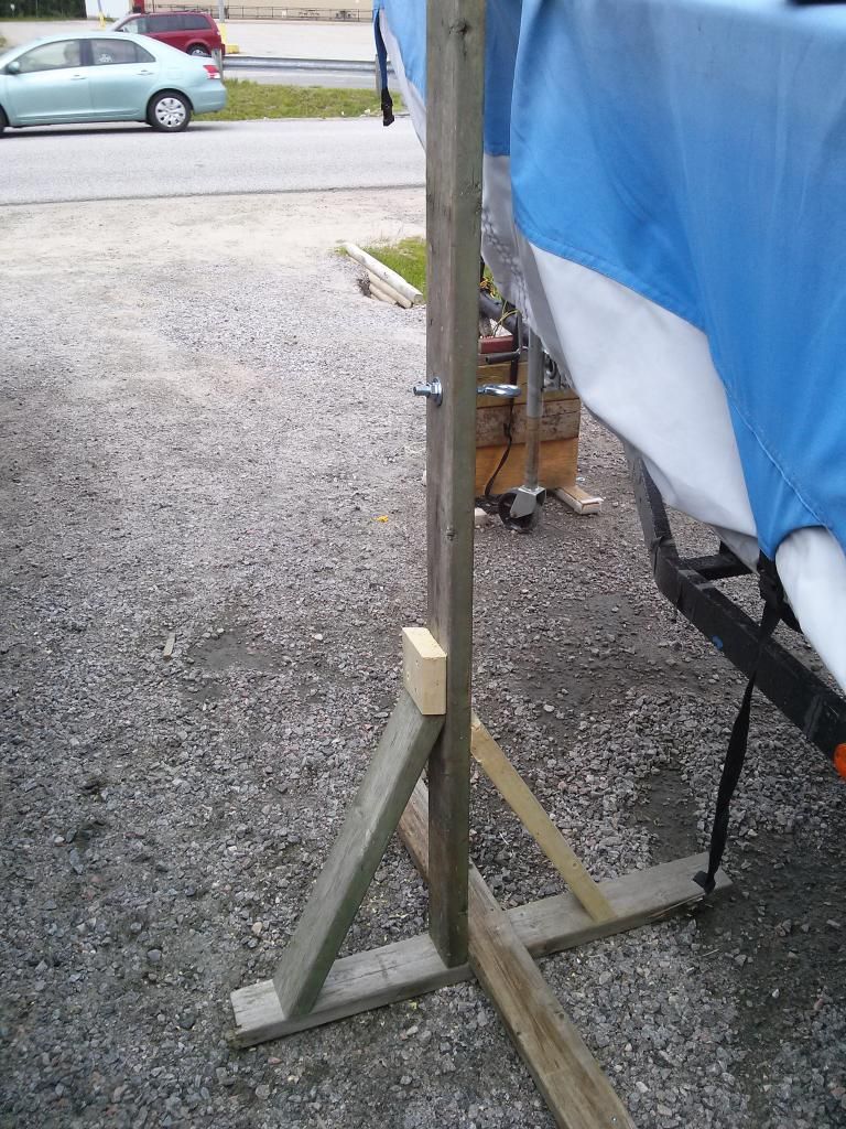

My method to get boat up off the trailer. Home built stands, I will run a ratchet strap under the boat front and back and ratchet it up off the trailer. I have since installed a cross piece to brace the tops so they don't buckle inwards. It has worked good so far, boat is up and I'm ready to pull trailer out. Rain came along and halted work last night.
Planning on lowering boat onto some old tires and then turning it about 3/4 the way over, so can work on the boat easier. (will have it propped up by some 2x4s) More pics tonite when I get out home.

It looks like there has been some kind of sealant brushed on the inside of the hull before, will this need to be stripped off as well to re apply a coat of sealant? I assume so, but it will be a job to get all that clean enough..yikes.
jigngrub
Mar 19, 2011
8,155
Good prep work and the removal of all old material will ensure your fix will be long lasting.
jbcurt00
Oct 25, 2011
25,261
Post a pix of what ur seeing @bondo stuff you mentioned initially & whatever sealant your seeing now. Brushed on sealant is on rivets & seams? Perhaps it wasn't properly prepped or applied so it didn't do what it was supposed, seal againnst leaks. If so maybe it won't be so tough to get off. Awful big maybe, though... Post some more pix & good luck. .
