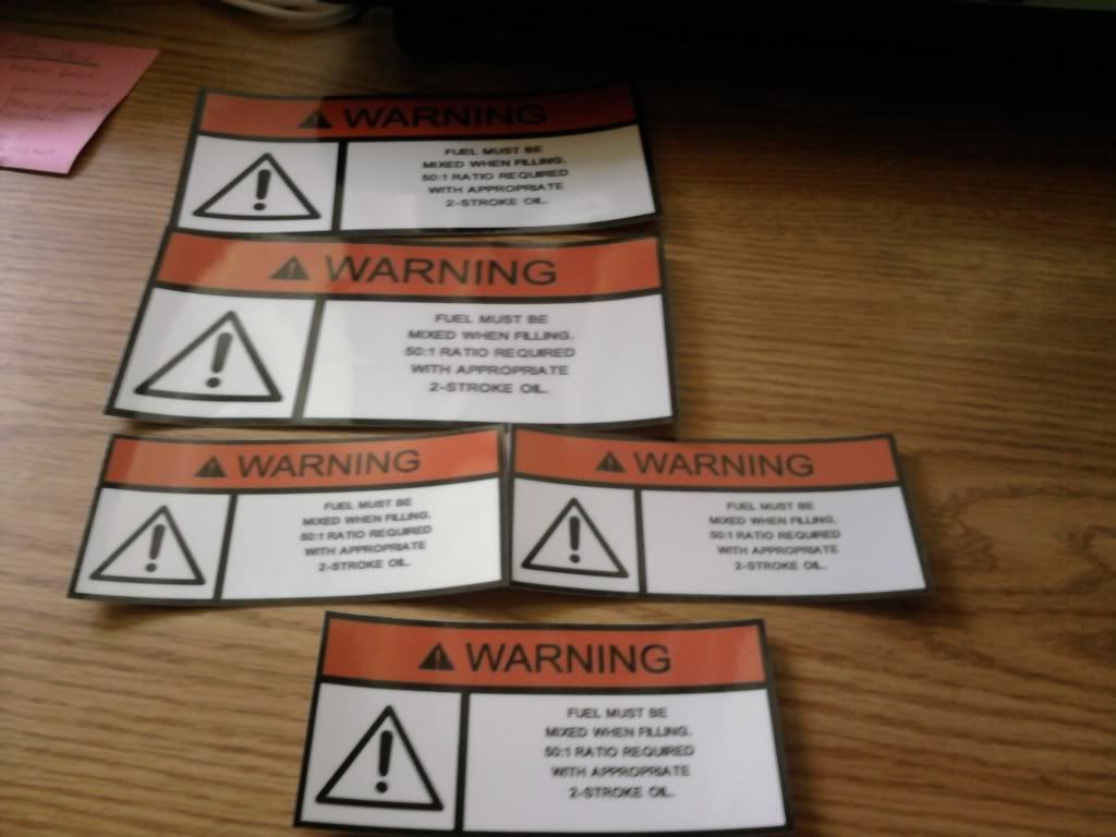

Order three stickers (37-818029 1), one to mount near the fuel fitting on the motor, one for the dash, and one near the fuel fill fitting on the boat. They'll alert the operator that the gas needs to have oil added. One frequent problem we see here regards the infamous "brother-in-law" that forgets to add oil to the gas and roaches the motor.

John helped me a ton when I did this to my motor last year! I ordered my blockoff kit and screws from an online dealer as my Merc dealer couldn't get the part for some reason. The stickers that John listed were also no longer available (thru my dealer anyways), so I had these made up at a local sticker shop. Put one by the fill, on the cowl, and up on the dash. They work/look great.

I have also followed the advice about the warning signs. However, my mate is a sign writer so he made me some up - one fitted to the fitted filler cap on the stern and one fitted on the dashboard.
The measuring jug is permanently carried in the "toolbox" on the trailer. It is already marked clearly so it easy to measure the amount of oil for my jerry cans. Hope its simple enough that there is no mis-understanding no mater who is filling her up.
