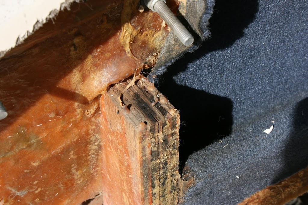

no wonder boats rot out

Re: no wonder boats rot out
Yeah when I took my skiff apart, I saw that they never covered the wood with glass.
They just glassed in the borders and left the rest of the wood exposed.
Plywood can be a great building material, but we all understand what happens if it's not managed properly. I probably overdo things a bit, but I don't use plywood anywhere on my boat unless the faces are glassed and the edges are soaked in epoxy. Any more, I just glass the whole sheet and go from there.
The edges have to be soaked in epoxy, or preferably edged in mahogany to seal out water. (See edges of transom below.)
That's why every peice of new plywood going onto the boat is coated with epoxy resin. Atleast 2 coats. A little on expensive side but atleast i know it won't rot out
Consider, instead of 2 coats of epoxy, a layer of glass instead. The glass will hold up much better, add stiffness and even the thinnest cloth out there will be much more durable than two epoxy coats. Thin cloth will take much less epoxy than two full coats and may even be cheaper. A win-win, really.
My boat had the stringers directly attached to the transom, so when one was compromised and rotted, the rot would automatically spread to the the other. Brilliant design, eh?
Makes sense. Currenlty making new seat frames and boxes. If they were fiberglassed it could be real fun trying to get a staple to go thru it. It's hard enough with just epoxy resin
