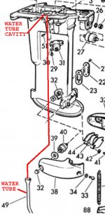

The flared upper end of the water tube is simply a tight fit into the cavity in the housing. No rubber seal or anything. It is not unreasonable to expect some leakage, but certainly not enough to have a negative effect on the cooling. Unless there is a big chunk busted out of the castings, remotely possible, but extremely unlikely. And all those passages are big enough to stick you pinky finger into---not likely to plug up.
If you truly think there is an obstruction or bypass, it's time to pull the powerhead and look for it. Personally, I think you are barking up the wrong tree.
