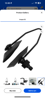

What kind of muffs do you have? On my mercruiser (1976 888/mc-1) I ended up having to use the bravo-style mercruiser muffs (looks like a set of crash cymbals). I had no luck with an "earmuffs" style muff set and bbq'd a new impeller partially as a result of such. You will have to drill a hole in the intake plates to use said mercruiser muffs (for the retainer rod/wire, see manual).
DuKn
Jul 15, 2024
61
Everything ran fine on my muffs before hand.
