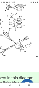

Back on your engine harness you will see a black rubber boot. Inside is the fuse.
