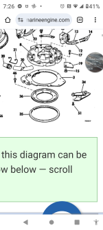

I saw the old controls but your key switch grounds out the motor to kill it. Came with the black plug I presume?
This part failed this weekend on me creating havoc...that's why I asked about the timer plate. With the motor off and you rock the flywheel back and forth, observe the timer plate.
The plastic ring cracks and breaks up.

What mine was doing, is when rotating the flywheel you could see the timer plate bouncing around. Pull the 6 or so Phillips head screws on the top of the timer plate and inspect/clean/re-lube the plastic bearing. Mine had missing pieces.
