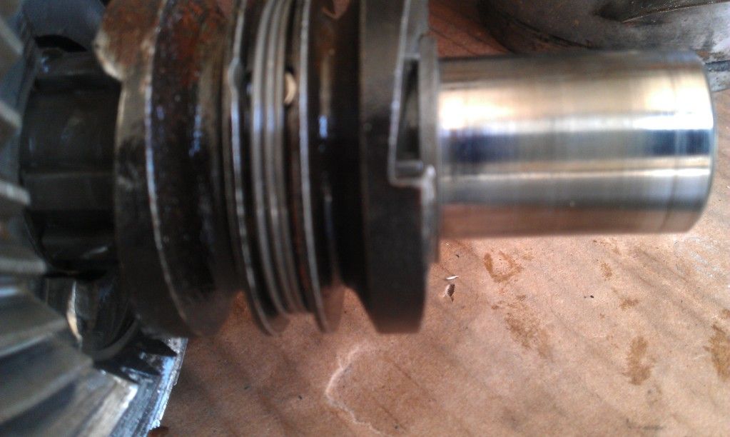

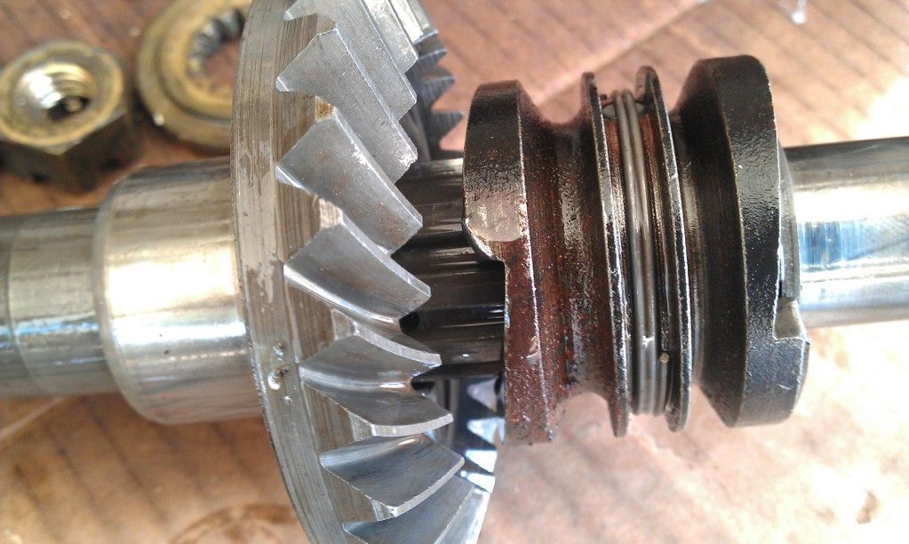

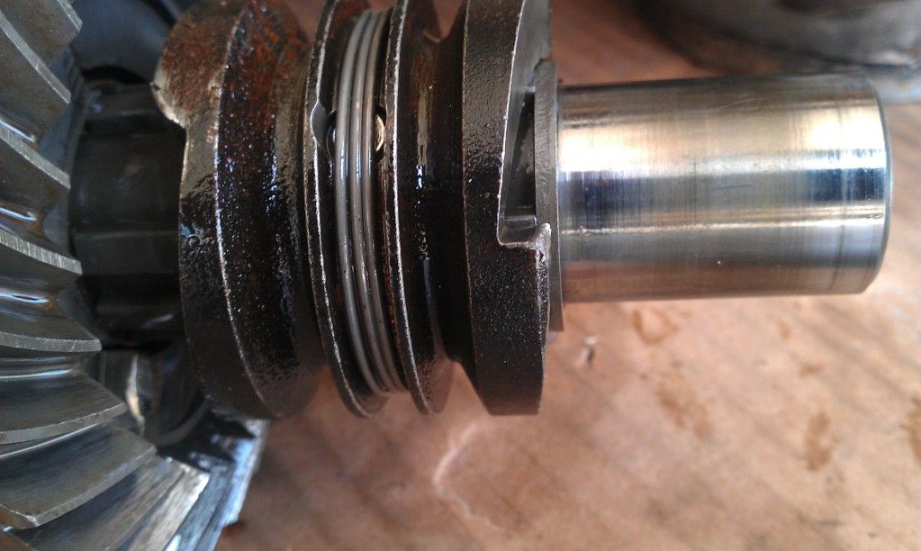

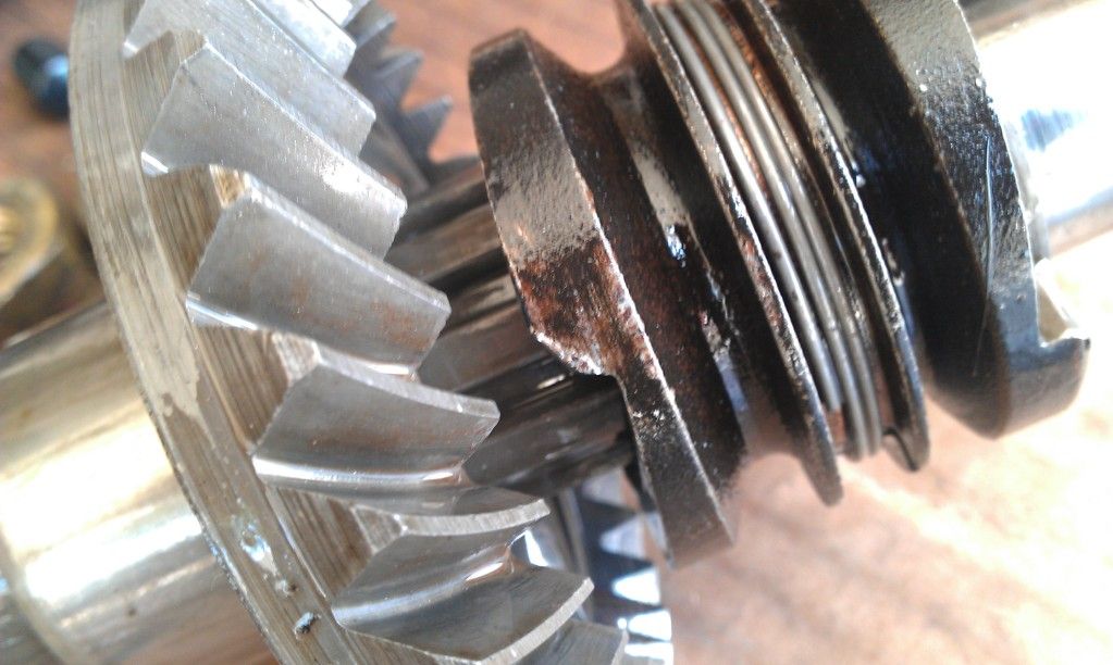

Update:
I pulled the prop shaft to inspect the clutch dog and gears and it looks like my clutch dog is pretty worn. The clutchdog has rounding on the reverse side and a little wear on the forward side. The reverse gear also has some rounding but the forward gear looks okay. Could this be causing my shifting issues? Also, how do I take off the clutch dog from the prop shaft? Thanks. Bellow are some pictures.

How do they even get the spring on the clutchdog?
durban
Master Chief Petty Officer
May 27, 2011
894
Re: 1971 Johnson 85 Shifting problem
it gets fed on in one direction staring with the end like a spiral feed it i clockwise or anticlockwise depending wich end you start with would feed it off to the grove next to the one its in now , once in there then over the ends .

Got it. Thank you. I've never seen a new clutch dog before and was wondering how bad mine looked?
the left hand side is cooked by looking at photo

That's kind of what confuses me is that I'm having issues with forward just reving with no motion. The gear don't seem to be engaging but I can get to reverse just fine and the prop moves counter clockwise. Now looking at the clutch dog, the reverse gear side looks toast but the forward looks okay. In my head I think the symptom should be reversed in that the forward should be working the reverse should just rev.
there is a reason for that dog being worn like that , i would make some adjustment on the shaft that engages it , ive never done one before but i would try try & work out why it happened then fix that other wise down the road you will end up with the same problem
maybe take it off the shaft & turn it around , providing both ends are the same , it should work
looking at the photo carefully i see a pin under the spring , now that tells me the pin move in a groove or goes through the shaft , i dont know your set up in the shaft , it could be the pin is worn or groove , just studying the photos , take the spring off & check that , the spring is there to hold the pin in place .i would suspect the pin
Don't even think about turning the dog around as it only goes one way. You could have a prob with the oil pump or the shift solenoids.

Hey guys. Thank you for your reply.
Boobie, you are correct. After inspecting the clutchdog and trying to engage the forward gear,the clutchdog would not engage at all so I flipped the clutchdog the other way and then it started engaging but was slipping due to the rounding. After a closer look at the clutchdog the forward side is longer than the reverse side. Also, after removing the prop shaft spring, I notice someone had put an allen bolt inside the spring hole to load the spring but that did not work.
What I've done. I took my die grinder and a few stone bits and put the 3 corners of the clutch dog back to 90 degrees. I ensured the corners were grinded the same length. I put the shaft back in to see if I can engage forward gear and it worked. This will be a temporary solution as I wait for a new forward and reverse gears and a new clutchdog.
Nice boat. You probably have the first clutch dog on one of these motors I've seen go bad. They usually wear from slow shifts into gear, these hydro-electric units usually don't take thier time shifting.
