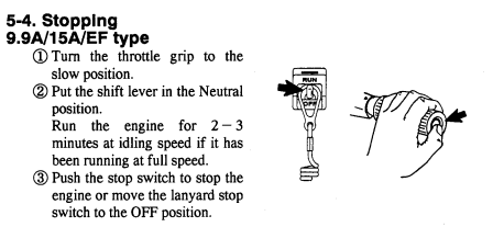

This is from a 2007 Tohatsu owner's manual for a 9.9 four stroke. There has to be wires from either the lanyard kill switch of the push to stop switch at the end of the tiller handle.

Motor was converted to remote control, no tiller arm or wires. I understand how kill wiring works, but there is no black yellow kill wire anywhere. I'm trying to figure out why no spark.coil and stator ohm tests good.
