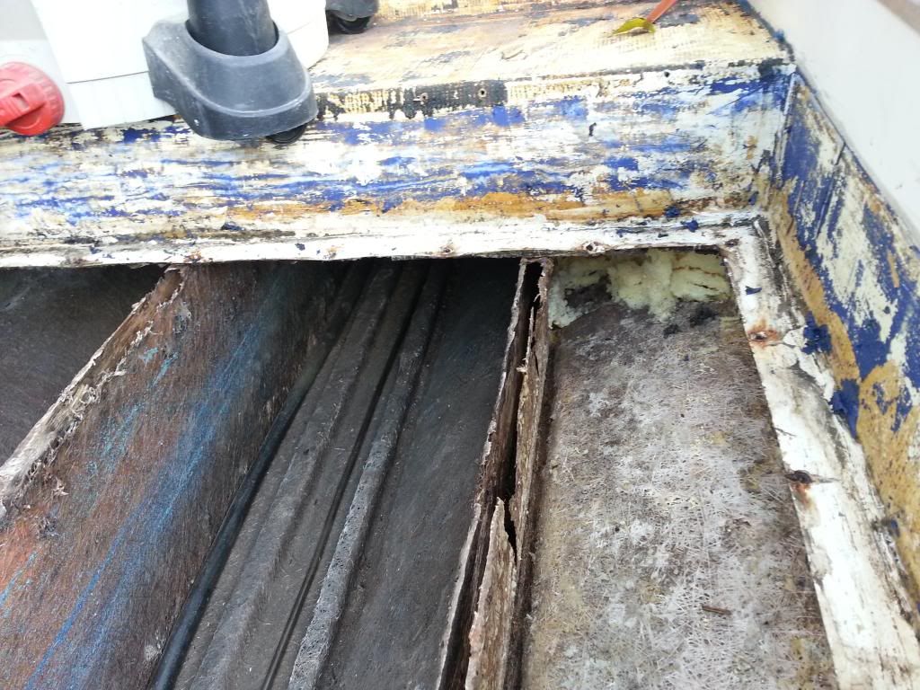

Here are a couple of pics as to what I have gotten myself into lol
Hey looks like it worked!.. Thinking it would just be easier to remove the whole cap... looks like the cap flange was riveted on top of a piece of 3/8" ply that was screwed to the stringers then glassed.. little hard to tell as the floor had been worked on before... don't see anywhere were the deck was ever tabbed into the hull and the wood floor is only in the center of the boat (in what i'll call the tub section of the cap) the bow & stern sections are all glass raised higher then the tub area and all glass... also notices that the stringers don't go all the way to the transom, the dead end on the hull just short of it? How much do I need to be concerned about flexing once I remove the cap? it's on the trailer supported on 4 bunks.. Will I have to build a cradle? PS. Thanks woodonglass for the help with the pics..

Yep, you got your pics working just fine...and it looks like you are in for the whole "shabang"...a full gut and restore...
I'll be tagging along to see what develops...best of luck and have fun!:)
