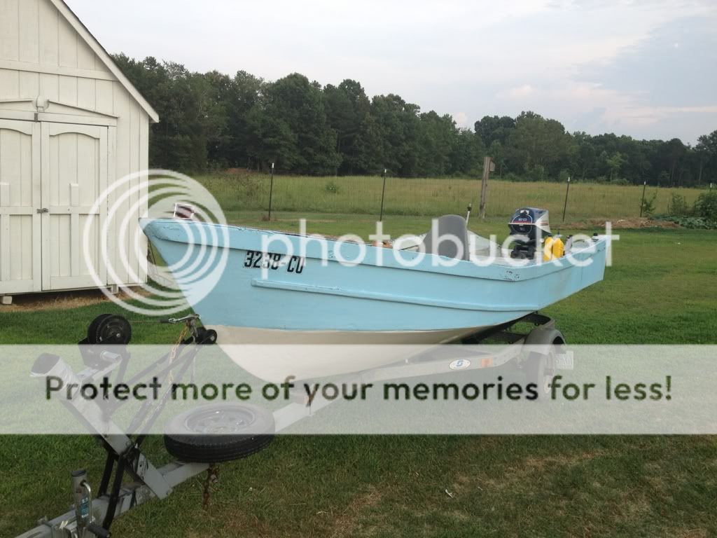

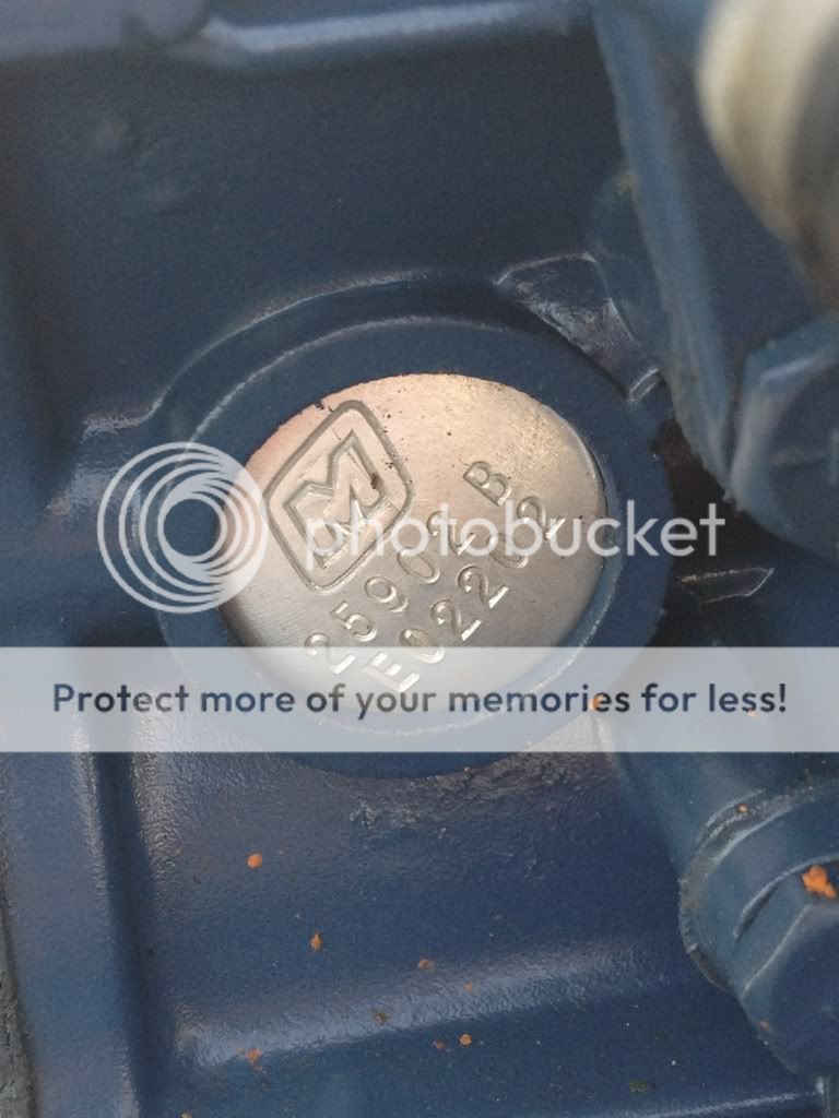

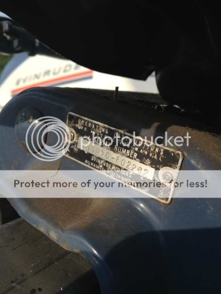

A few questions about my new-to-me 25 hp sportster. I haven't tried to start it yet but it looks like it hasn't been too long since it's been run. It turns over ok....feels like it has good compression. I might try to fire her up in the morning unless somebody stops me. I'll replace the oil in the lower unit first though. She was a salvation army donation and her hull's solid...built in 89-90.
What year is my kicker?
Throttle is hard to increase...decreases easy...is there an easy fix?
What's the correct gas/oil ratio?
Is there a secret starting routine?
A few pics below....anybody out there recognize her?....nc registration....i'm near charlotte.
