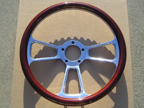

I wasn't too keen on the red and white steering wheel so I treated the boat to a mahogany half wrap aluminium one that I think will suit her, I didn't budget for this so I had to sell my seagull outboard to pay for it :D
