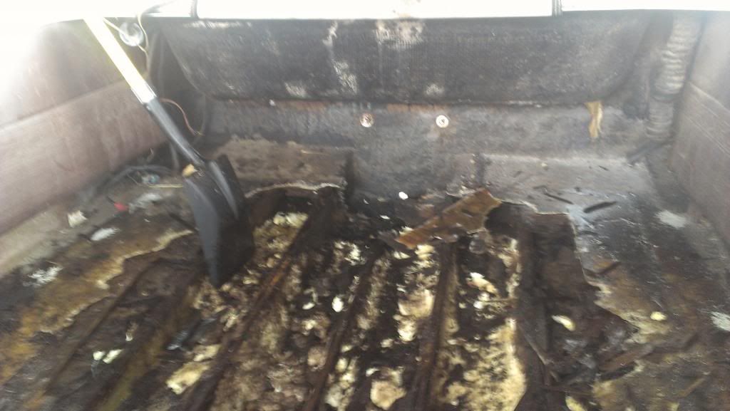

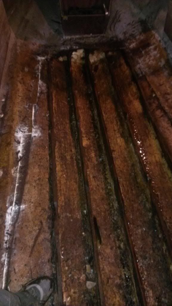

So here is an update as to where I am. I have ripped out most of the deck tore out the foam and cleaned it up some. the only good thing about it is the foam and wood was so water logged and rotted it came out really easy. I will upload pics hopefully I can do it right from my photobucket lol. I am having problems getting it from photobucket so will post pics like before for now until I get it figured out I changed all settings but it still wont let me upload them that way. decktoreout1.jpgdecktoreout2.jpgdecktoreout3.jpgcleaneup1.jpgcleanedup2.jpg....I apologize for doing it this way just don't have to at the moment to figure out photobucket. I would also like to know the easiest way to get the starboard and port side of the deck out whick tools would help ease the job and whatever other advice or opinions would be greatly appreciated

Like this? lol sorry just been a long day. I am also wondering if what you see in the pics if that is bottom of hull and that the stringers are that small? If so will be nice since I can then see how much wood I need to rebuld stringers and deck
Sure does look like it from this distance...;)

Here is what I did so far as ripping out the foam which was pretty easy since it was so water logged. what would be the best/easiest way to get the stringers out?

Nice I thought so. Just seemed not deep enough but then again it is only a 16 ft boat

Some use a reciprocating saw with a thin flexible blade and get under the stringer, then cut along the bottom edges as best as possible...
Others use and oscillating tool, but I hear the blades tend to wear out quick...
Then there are the adventurous fools like me that used a 4" angle grinder with a metal cutting disc and cut along both sides of each stringer in the hopes of removing them mostly in one piece and not creating any additional high speed water intakes:eek:...don't ask me how this is possible...it is well documented early on in my thread...:facepalm:
