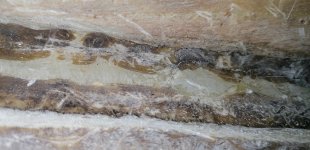

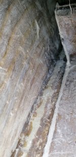

So, these pictures show how long the cracks are and how close they are to the transom skin.
Current thought is creating two bewels on each side of corner and then start building from the crack (essentially center of inside corner) with really thin strips of fiberglass (for which a sharp angle would not be a problem) until I have built up something like a fillet with biaxial mat in the corner and then start laying the mat over the corner stretching a bit further onto both hull and transom.

Sorry to say. I really can't make heads or tails out from either pic.
unless what I'm seeing is really enlarged.
Fiberglass is forgiving if you take the steps that it responds to.
If things don't turn out like, you like... sand it down or smooth it out and give it another go.
you can make the radius that works for you and the glass, a compromise.
Back to grinding out those cracks...
If it were me...
I would sand the area, Not Grind the cracks out or away, But prep the surface for a lay over or 3... Until you feel certain that you have blended and built up enough to cure the problem.
My thought on this is grinding away material just to remove cracks or to hold a radius. Is removing strength that you have to replace.(Leave It)
Unless you feel there is contamination like oil or mold.
If it works against you to grind the cracks away. sand it and build it up and be done.
Fiberglassing is what you make it out to be..
Remember. epoxy that is a thin viscosity can seep into these cracks and fix alot of your problems anyway.
Now again surface prep.
Sand, grind, scuff.. Get any oil out. Acetone, with careful use of air hose can lift stuff out you could spend hours on cleaning.(safety glasses)
Another option is Dawn soap and add hot water will flush contaminates out, again air hose used in the right way can speed things up.
(Again, safety glasses)
A Clean, scuffed, Dry surface. And build it up.
If the radius takes more room than expected you can shave or grind any wood to be set to match "Your Work" Blend it..
This stuff doesn't have to hold 0 tolerances. If you add an inch in glass and wood was supposed to go there cut the wood.. an Inch.
This is now "Your Build"... how you want it. Make it yours.
Fiberglass and epoxy is much stronger than many give it credit, or realize.
2 extra layers is better than,. 1 layer too few.
Have fun.

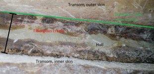

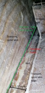

Ok, I have highlighted the different things in the picture to make for easier viewing and orientation. As you can see the cracks run parallell to the transom.

I'm honestly not sure what could be in the cracks since they run quite deep (1/12 - 1/8") so I'm unsure on the adhesion if I would just let resin sink into the cracks. Smelled something petrol like in the old wood so it seems the old core had sucked up some (oil mixed) gas.
I see some old repairs on the outer transom skin where the adhesion failed that I'm also fixing now. Want to make sure that if I make an effort to fix these cracks that does not happen. Thanks for the tip about the acetone + air hose, really had not thought of that as a solution to get stuff out of the cracks.
