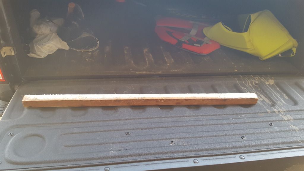

Found a piece of wood in my ski locker today (First pic). Looks like it may be a support under the edge of the opening of the ski locker.

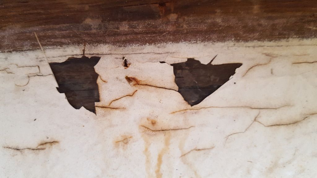

The second pic is under that edge, inside the locker. I put an arrow where it looks like the wood used to be.

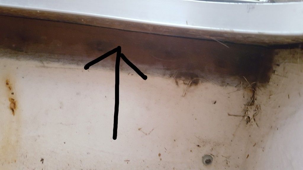

The third pic is of the ski locker, and I drew an arrow to show exactly where, just under the metal edge.

JP127, well it certainly looks like there was something there at one time. But I am not so sure that piece of wood was original. It is not coated with anything and that seems strange to me. I would have thought they would have used something coated to make it last without rotting. But that is only a wild guess on my part. I would think there should be something there to allow the edges be support better. :noidea:

Pull off the aluminum frame of the ski locker door. See if the edge of the plywood decking was treated, or if you have rot in the edge of the deck. If you have rot, that will need to be fixed. You can install cleats under the ski door frame, to help support it, but if the deck rot persists, the cleats will fall off.

Something was there to bolster the edge of the locker. That piece is not original. It was most likely glued in. I would treat/varnish a similar piece of hardwood or use cedar and use 3M 5200 to glue it in. I don't like drilling holes in boats where the manufacturer didn't, that's me. It is certainly not a stringer.

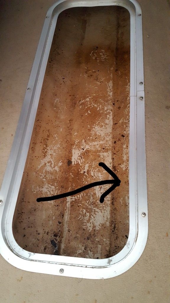

Looks like the wood went length wise down the ski locker. I bought pressure treated wood to replace it. Also looks like they were stapled along the wall of the ski locker.
My plan is to let the wood, along the ski locker walls, dry out and replace it. This time I'm not going to use staples or screws. Just going to use 5200. Thoughts?

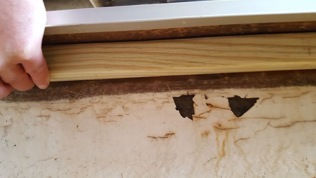

I peeled back some fiberglass and the wood feels firm.
And then I'm thinking of glueing a new brace here with 5200. This is where the original brace was. As you can see, it's a little smaller. I'll glue it to the side and under the floor of the boat.
I would then like to find something to coat the wood and cracked fiberglass to help keep it water proof. Suggestions? I'll also fill the areas where I peeled back the fiberglass. Suggestions? I really don't want to use actual fiberglass. Hoping there's something easier to apply. It doesn't have to be pretty. Just functional. And whatever I use to fill the areas I'd like it to dry white.
