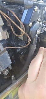

I have what would appear to be a 1976 35hp johnson. The lower unit has the serial number 35r76g, and appears to match that. However when I use that number to find parts for the engine, none of the oem diagrams look like my engine. I even bought a replacement fuel pump but failed to notice it had only 2 connections, where the original had 3. I've looked through countless oem diagrams from the 70s up to the 90s, and from 5hp all the way up to 50, nothing seems to match. Can anyone help? Some serial numbers I've found include mx340913, 326713, 335635, 436366 if that helps.20240317_095617.jpg20240317_095647.jpg20240317_095702.jpg20240310_154656.jpg20240317_095611.jpg20240317_095601.jpg

The fuel pump mounts directly over the PRESSURE pulse port.----So therefor the fuel pump is not the correct one and no surprise to me.----These simple pumps are not well understood in my opinion.----.----It does work with a hose to the pressure port.----And this powerhead has electronic ignition.----So it is not a 1976 powerhead.----Powerhead might be a 77 or 78 year and possibly newer than that if exhaust tuner was also changed-----It should be easy to find parts as these engines and many parts ( except for the block ) were the same.

So the block for the 77-78 year motors have only one pressure port and it is behind the fuel pump correct? My motor has that as well as a separate connection with a hose...
39,748
Correct , the 76 was mounted directly over the pressure port , with a hose for fuel in and one for fuel out.

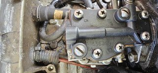

Mine also has this, which I assume is another pressure port. It was connected on the old fuel pump. The one in the picture is the replacement I bought with only the fuel in and fuel out. It still runs strangely enough.

It appears that around 1990 ( 30 HP prop rated ) they fiddled with different a fuel pump.----With that extra pulse port for some strange reason.----Using 2 ports would make no difference in engine operation.----You can block off the extra pulse port.

Thanks for all the help. I've actually had the boat for a while but never really looked into it because it runs ok. It's got 115 psi on both cylinders, pees water fine. I've taken it on the water many times and it'll take my 14 footer with 2 people about 25mph. It seems like the carb might be from a 15-25hp or somewhere in that range. Any advice for how to figure that out / find a compatible one?
39,748
Take the carburetor off.-----Inspect.----Report the number you find on the high speed jet.-----Yes this powerhead was marketed as a 20 hp for many years.
