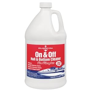

Here is what im at currently after discovering a hull cleaner called off and on that does a decent job!

What did you use to take off the bottom paint?
Nice work!
swflhummer
Seaman Apprentice
Dec 14, 2010
34
Re: My First project boat. Tips Idea's appriciated. Larson Flyer
I used on and off hull cleaner. I had trouble finding it and then I went to Bass pro and they had it.
It says use a sponge to put it on... That was a fail. I got a spray bottle, sprayed it on, let it soak for about 2 minutes, then got a scraper and just scraped the majority of it off. THEN get a sponge with on and off on it and just wipe the rest off. Get a water hose, spray it all down and ur done (wipe dry if ya want too).
I highly recommend not spraying while the wind is blowing. It will kill you slowly and my god it hurts. lol
