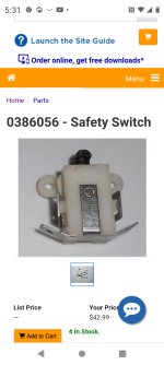

I'm thinking the nutruel safety switch on the starboard side.(mines on that side) When in nutruel it grounds the soloniod which makes it work. To test, put a jumper from any engine ground to one of the small leads on the solenoid. Should be the one closer to the back or the one that DOESNT have the red wire.
I think it's brown or tan.
If it turns over that little switch is bad.
This is the part.
