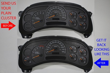

http://www.fixmygauges.com/conversio...-upgrades.html
6a1b6276907e12928e1210e8d3a38002
At least now you have Dexron VI spec transmission fluid in it. If you had never done a complete flush of your old transmission fluid, you likely had Dexron III which had much lower temp specs on it.

That will work. I just wanted on my dash so I don't have to mess with anything while I am driving.
The gauge on the dash is much cleaner. However, since 95% of my tows are 10 miles or less, I will only need the gauge for a few trips a year so the temporary gauge makes sense. Plus I am cheap.
