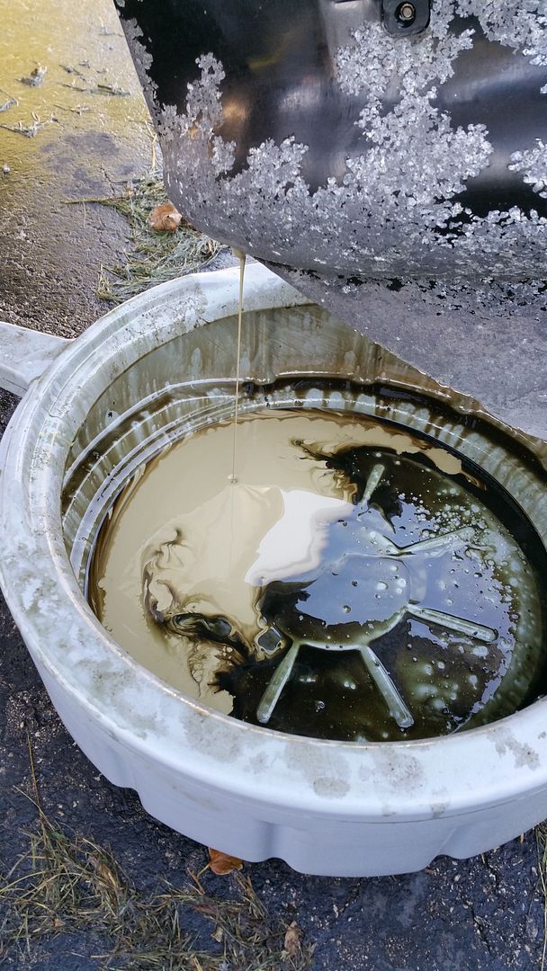

So, When winterizing, this happened, The dark oil is from changing the oil in the boat. This was a cheap boat (1978 18' Webbcraft with Mercruiser 228 - MC1 out Drive) The milky oil is what came out of the out drive. What are the next steps? How worried should I be?

Not necessarily. Just leave it empty and remove the drive. We can walk you through testing it and deciding how to proceed.

I had some issues like that with my Bravo drives last year. It is a matter of pressure testing the out drive to find the leak and fixing what is leaking. Hopefully it is just a seal or two.
Looks like there is a fair amount of corrosion on the casing. So, maybe get that in check while you are working on it.

Ayuh,.... Agreed, 1st step is pullin' the drive,....

The milky oil is definitely bad.
One other thing to look at... Does your drain plug have a magnet built into it? My plug on my Aplha 1 Gen 2 has a magnet and I always take a close look at what it has collected. Usually at the end of the year it has a coating of teeny tiny metal dust flecks over the magnet. Any more than that, especially big chunks, would give cause for concern.

Ok, One shoulder surgery later and my arm is back in business and ready to test and rebuild. I Pulled the upper and lower when I winterized and have the outdrive sitting in my attached (Heated) garage. What would be my best steps to get this working. As a side note, I DID replace the sea impeller before putting the boat in the water this past season, any possibilities that the seal on that short pipe running between lower and upper was bad and that's all my problem is?

That short pipe is just a guide for the main tube for fitment. Even if both where bad it would not cause water in the lube. You need to pressurize the drive with air and find the leak. You can use a spray bottle with soap and water to help find it.

My leak is in the drive shaft housing. Air comes out right by where the U Joint Shaft leaves the housing.
