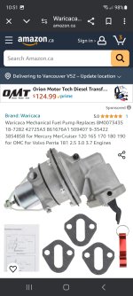

I have an old Mercruiser 470 in my boat and recently had fuel pump failure. I'm looking for a new fuel pump but am having trouble finding what I need. Does anyone know if the 170 has the same pump as the 470? When I Google it in get all kinds of conflicting results. When I search for the 170 pump there is a couple that look exactly right but they don't list as fitting a 470 engine.
The one in the picture seems to be right but doesn't list it as fitting the 470 (which is pretty much an identical engine.)

Depends on what your serial number is . There are three different listings for the 470 depending on serial or year range. You can click on them drill down to fuel pump. looks there are two styles depending on if fuel bowl is up or down

Not in this case. The only thing Ford on the Mercruiser 470 is the head (modified with a big ole hole), pistons and rods. Everything else is GM or custom Mercruiser. It's a Carter marine pump, similar to the 3.0
