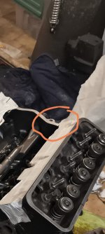

Place intake gaskets in place, then put a bead of the black RTV starting on top the intake gasket about 1/2 inch. Run bead across and up on the other gasket about 1/2 inch.
Don't get any sealer in the oil sending unit hole on the rear

Thanks so much oil sending unit you mean the one that goes here in the picture?
Not even thread sealer?
Yes, that one
Yes that's the sending unit hole. Sealer isn't really necessary but you can use just a bit only on the threads, I think it is a taper thread type seal.
