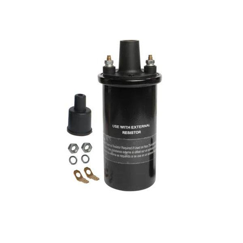

I just dealt with something VERY similar on my 4.3 LX - I went to winterize, warmed up my engine, turned it off because I forgot the fogging oil, came back and couldn't start it again for months as I was trouble-shooting it during the winter. I also had spark and gas and I tested the resistance of my coil across its terminals to make sure it was within specs. My specs were here:
