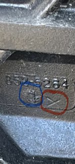

Still curious about the block stamp. Only ones I’ve seen any reference to is the j block, and then one forum page that talked about a circled ‘C’ stamp block (didn’t really read into this one as it wasn’t what I was looking for). Otherwise everything else was later blocks with the double letter stamps. Cant find anything for the single ‘X’ stamp next to the part number. (Red circle). And then was curious on what the blue circle is a casting of. I know it’s raised so it was a cast mark.
