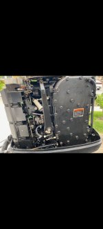

So it was taken out last week and it died right at the LiveBait shop. Several attempts were made to start and it would start and then die. The owner did the compression test which showed 120s across but did not ground the cables so now it has 2 problems. There is a no spark condition on top of the start and die one. I did open up the fuel pump and found only a slightly bent clear circle piece(don't know the name)on one of the check valves. I flipped it around and it seems to sit better. Ordered a kit for it. But diaphragms were ok.
I did find a video that shows the steps to test the no spark issue. Any help would be appreciated. Thanks in advance.
Engine looks like the picture.

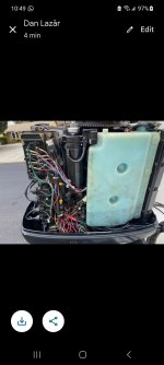

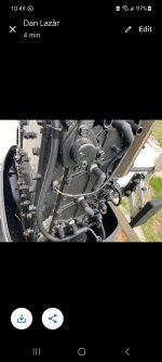

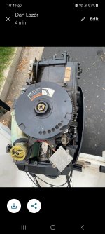

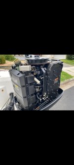

Yeah it is not my boat, it is a 1996 model, with a Mercury 125hp outboard.
For some reason I did not get notifications on the responses here. Sorry for the late post.
gica
Feb 24, 2016
363
Ok these are the pics.

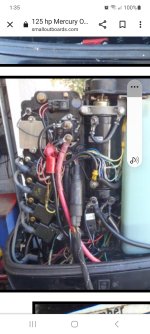

I visited this site 3 years ago and he does a good job of explaining the tests. He has what appears to be a 115 1995 model Mercury. Yours may be slightly different in the actual readings but should be close.
