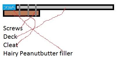

Here's how I'd do it. If you can get to the under side of the side of the hatch you would install a piece of 1/2 plywood as a cleat by screwing it from the topside and countersinking the screwheads and patching with pb. You would then Mix up some Hairy Peanut
Butter with lots of cut up CSM strands to give it a lot of structural strength and fill the 1" wide gap needed and make it a bit high. then Sand and smooth to final thickness. I think this would hold up well. You might want to grind it down a bit an lay layer of csm over the seam to keep it from developing a crack there on the seam. That's my 2?

Wood's suggestion is a preferred way, IMHO...you could also add a layer of CSM to the cleat before installing it with the screws, if you can grind the underside a bit to get a good bond...another alternative would be to use 5200 to glue the cleat to the underside for added strength...
The only thing I would maybe change is instead of filling in the void with thick PB, is to make a filler piece of plywood to take up most of the space and then 5200/CSM it all together...

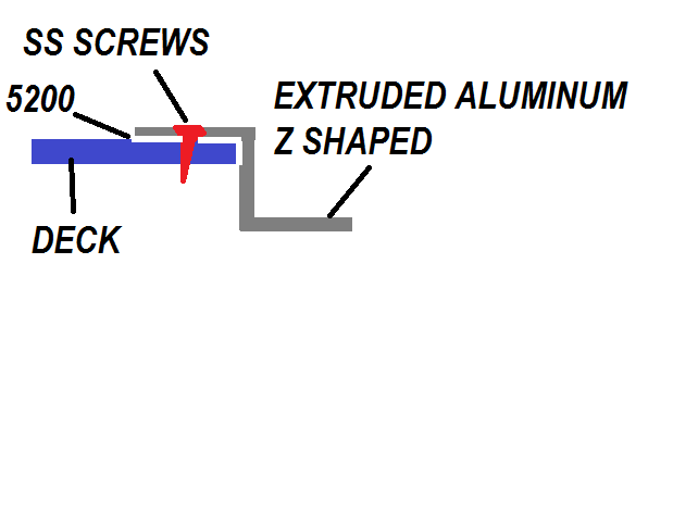

Another possibility is to get some extruded aluminum in a Z shape...attach to the opening on top of the deck with SS screws and 5200...
I don't think it would be as strong as the repair involving fiberglass, though...unless you add the cleat also?
