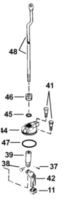

As Racerone says replace the driveshaft seal below the water pump. ( only one seal, but a double lipped one according to the parts diagram) # 36 in the attached diagram. Also replace the housing O ring ( #34)
Also consider replacing the shift rod O ring seal. #45 in this second diagram. Also renew the housing O ring , #47, if you disturb it.
