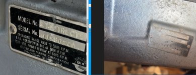

My Evinrude 1985 year 140 HP motor(”E140TLCOS“) lower unit broken. Could I replace it by the lower unit of Motor model "E140TRLCTE" 1983 year 140 HP? There are one thousand kilometers distance between these two motors.
What is your secret to search interchange lower unit? Is there any interchange list for my lower unit ”E140TLCOS“? for exmaple, Any 120/140 Johnson or Evinrude lower unit will fit from 1985 (large lower unit) to 1989(small lower unit) will fit, correct?
Thanks!

Gearcase part numbers are different on each motor so I would guess it's a no.
Faztbullet
Mar 2, 2008
15,938
Your 140 could have come with either the large or small gear case which both have the same gear ratio. The 1983 will be the small gearcase but will bolt up as DS length is the same.
