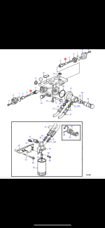

Hi again.
Been away for the weekend. Not sailing 😳
I have got this from a Penta mechanic to day.
He told me to look at this. See picture.
The two parts marked in read.
MrKav
May 16, 2023
8
No oil but where is supposed to be.
No damage to wires.
Had a manual pressure test on it also.
Confirmed around 20psi in idle.
I can maintain normal pressure (60psi) in neutral with 1500 rpm’s.
