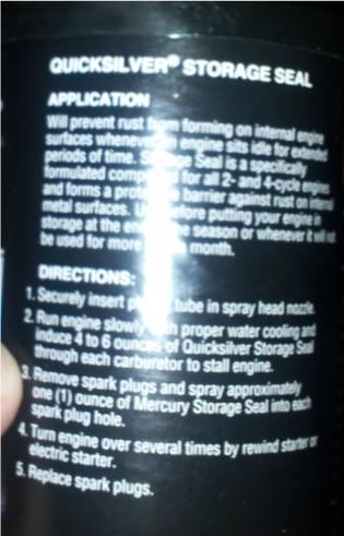

TomB985
Apr 4, 2011
213
Re: Lost Straw in Engine
Just curious... But why are people removing spark plugs to fog the engine? Don't you guys just spray it down the carb until the engine stalls out, like the instruction say?
I did both through the carb and into the cylinders on mine. The directions told me to!
I apologize for the poor photo!

doehl1
Recruit
Mar 6, 2009
Thanks to all for your comments. Glad to know this isn't a big deal. Will sleep better for sure. As for the comments regarding fogging the cylinders in addition to down the carb, it was on the instructions of the fogging oil container. In any event, not a big deal on my 5.7L Mercruiser to do this. Lots of room and easy to do, maybe 30 minutes to do all eight cylinders. Also makes for an good reason to do a check on the plugs, which should be done at least once a season anyway, no?
