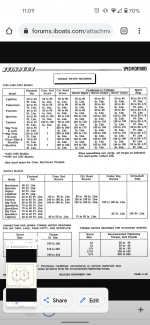

I found this torque guide for the head bolts, but it only gives names of the model, not model number, so that's what I was trying to figure out so I get it right.

Yeah, that's what I figured. You are good to go

Sorry I guess I'm confused, I'm good to go for what? I don't know what the torque specs should be as the list I have is only model names, not numbers, and I don't know my units model name.

Stated another way, I believe I said an Evinrude Fastwin is essentially the same thing as a Johnson FD. Your chart says a Fastwin head is 96-120Inch pounds. So same thing applies to a FD, since it is the same motor. "Good to go" is an old term meaning all is well and you can proceed.

looks like in the above post its the fastwin, so i would use the specs for that model on the chart

Got the head on torqued to 96 then 120 in the proper sequence. She fired right up in first pull but when I brought her out on the water today couldn't do full throttle unless choke was on a little bit, does anyone have a carb rebuild guide, I already have the kit just no guide to adjust everything too?
