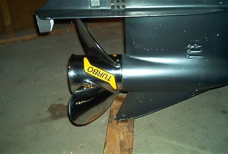

Here's a pic of how high the engine is from the transom...also how far back....<br /><br />
<br /><br />And, of course something else you may be looking for....<br /><br />
