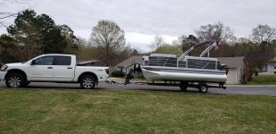

Hello I'm very interested in the performance of your boat! I have read many articles with the setup you have. I only hope it's true! I currently own a 2020 Godfrey Sweetwater 2086C. It has a yamaha 90hp SHO with currently run 28mph with just one person. I'm looking to add under penning and lifting streaks to my boat to get better performance. What's your boats top speed? Any info would be appreciated! I have attached a pic of my boat
