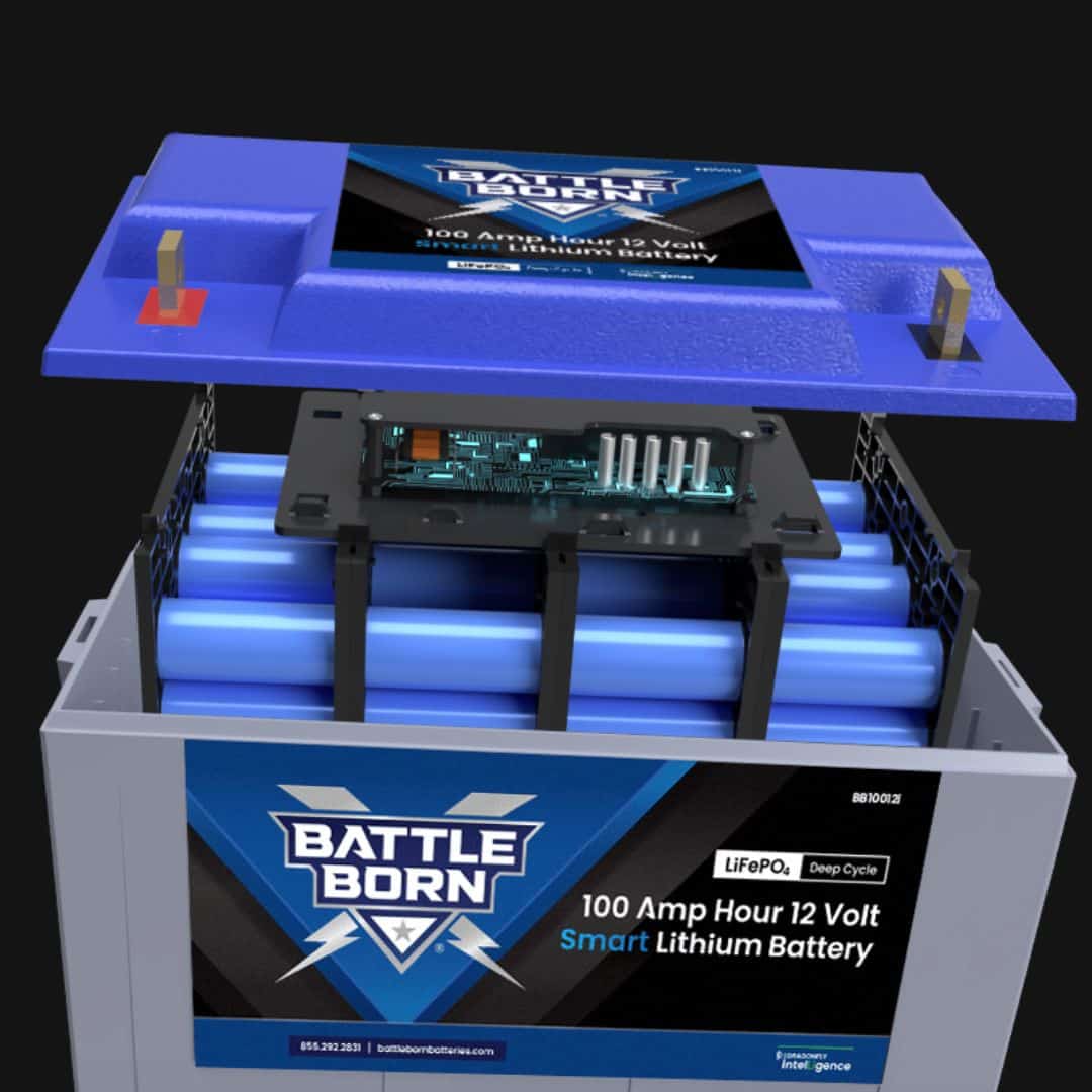

Yes, charging Lithium's at too low of temp(chem makeup can vary it somewhat) isn't good for them, I used Polymide heaters on a LiPo starting battery design for my snowblower so the batt c/would safely charge at lower ambient temps. Dewalt etc, even inhibit charging for their Li-ion's below some preset.
The BMS in LiFePO's above for example, is meant to automagic'ally take care of that for ya no matter where it is and when voltage is applied to its terminals.
