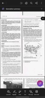

My 1984 Mercruiser's OWNER's MANUAL said to drain the water from the easily identifiable plugs, and then pull the TS and fill the empty block with AF. Of course then you need a new TS gasket.
The issue here is that everybody has an idea how to do things, but nobody reads manuals any more.

Nah, there was no recommendation for AF in 1984. They added it as optional later, then recommended. All for the same engines.
I bought the boat brand new in 1984 and that manual is what came with the boat.
I just looked thru my boat files to scan the winterization pages, but then I remembered that I gave it away when I sold the boat.
Since there were no internet or U-Tube videos back then, and I always did 90% of my own maintenance that book was my only source. I didn't just think it up.

Your reference was for a V6, years 1983-93. I don't dispute what they recommended in later years because I never read a newer book.
I'm really getting forgetful in my old age. As I said I gave the manual to the guy that bought ,my boat, but I just remembered that I also had a FULL Shop Manual that I DID keep.
The attachment is from the big manual, printed by Mercury Marine, copyright 1980.
All moot points anyway, since the OP didn't ask how to do it, but was merely making a comment.
Here ya go, this should be from your 1984 (also, 1983 is before 1984)
Again, accusing everyone else of being wrong is my issue.
The issue started when someone said they didn't pull the TS. I didn't say it was wrong to do that, I merely said that the manual said to do that.
Many of us on this forum don't think it's necessary as long as the water is drained. Mercury's comments were not directed at freeze damage, but more toward rust protection.
My attachment said exactly what I said.
