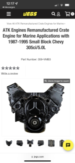

If it would cost less that $10k, I’ll book you a ticket now. 😂.
I’m a second and third opinion poster child. I’ve been researching since yesterday and found this…
Would this work?

We don't have your serial number I don't think. But if your engine is a 2001 vintage, that wouldn't work (wouldn't be ideal at least). The head design changed in 1996 or so in boats. Also, depending on your fuel system, upgrading to a 5.7L bloc would be pretty easy and get you some additional power. A lot of people (including myself) have dealt with michiganmotorz and had good experiences.
Oh really? Ok. Damn, you are all so helpful. I never expected to get this much information.
I’ll look up Michigan Motors now. Thank you a million!
