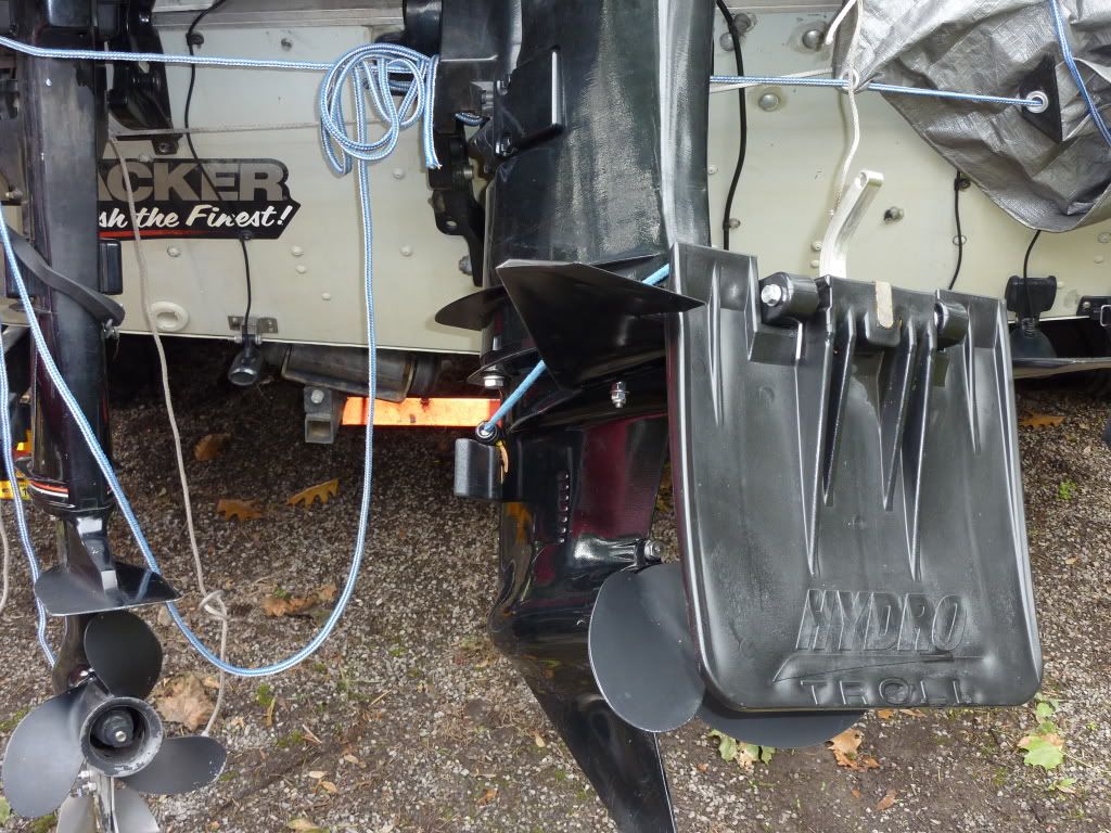

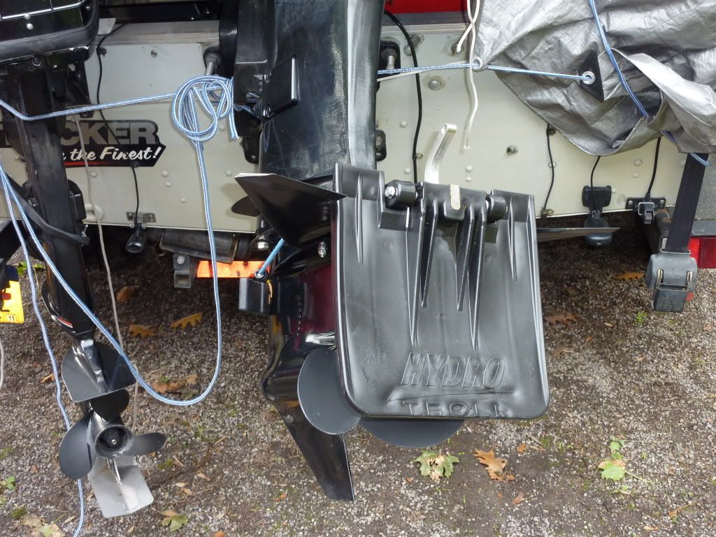

Looking at the back of the boat from left to right are: a transducer, the 9.9 Mercury, the 50 horse Mercury (centered on the transom) and another transducer. What I can't tell you, or find out at this time (boat is at another home) is if the left transducer is in-line with the 9.9 mercury. I also can't tell you if the forward mounted fishfinder is having the same issues as we haven't used it on these outings. All stuff for me to check on and report back after our next outing. (it won't be this weekend as waves are predicted to be 11-15 ft) We caught a small rainbow trout and a small Coho salmon on this outing. We have had problems with the forward fishfinder giving us crazy depth readings, from reading elsewhere on the forum, it sounds like this would be caused by electrical interference.

Get some pictures of the back of the boat nanrabbott.

I'll post some pics this weekend. Can I have two transducers adjacent to each other? Will they not interfere? BTW, thank you for your good advice and suggestions.

I have to disagree fucawi in my experience it makes no difference which side of the motor the transducer is mounted and proximity is only to do with disrupting the water flow to the prop rather than the prop causing interference with the transducer after all the transducer is forward of the prop.
I always mount them on the starboard side but I've seen plenty on the port side that seem to work fine.
I think you need to do some testing nanrabbott, stationary with all motors off, each sounder, both sounders, big motor in neutral, kicker in neutral, big motor in gear, kicker in gear, it goes on & on but I think that's the way to get to the bottom of it.
Positioning of the transducers is important so pics will really help.
Boat was wrapped up for a storm that was coming, but here are photos.
