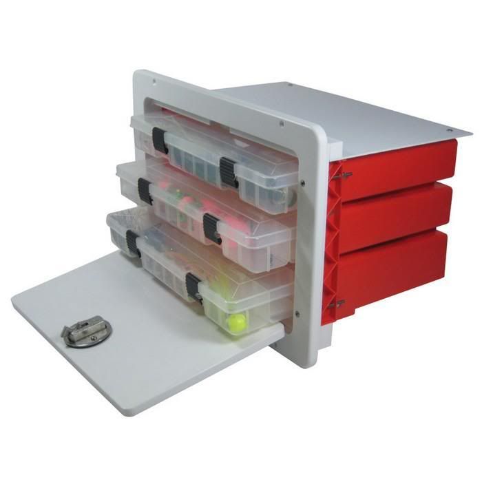

i want to get a couple of tackle storages like this in the pic and put them on each side of the console..

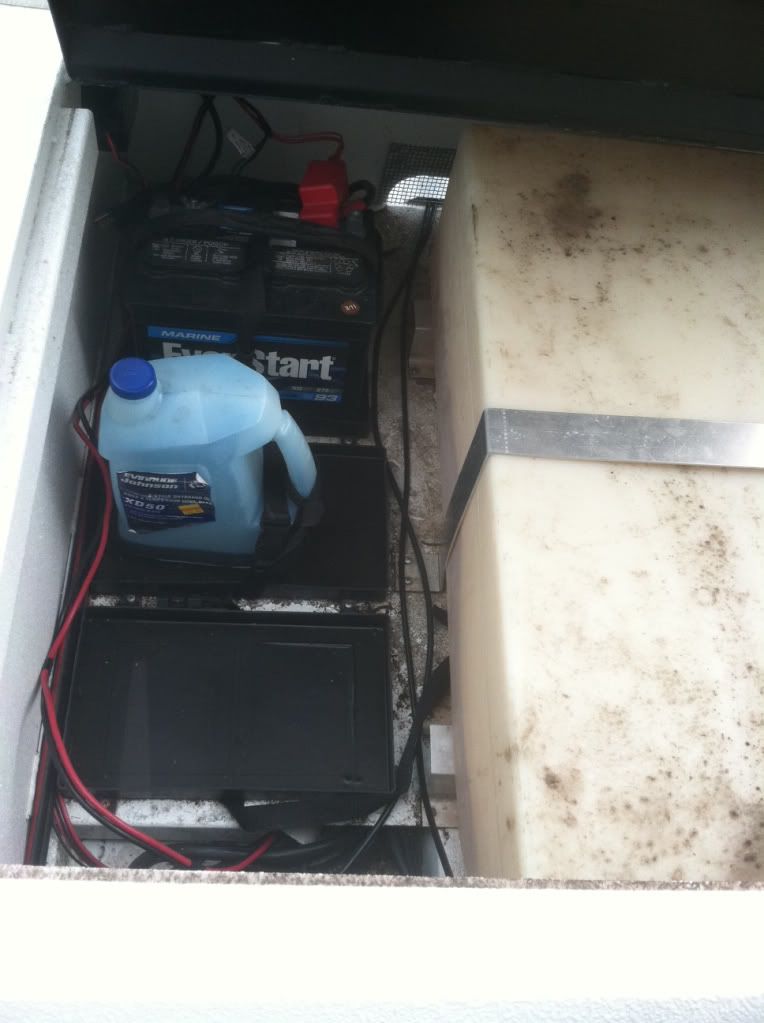

and here pic on gas and batt. compartment .. i like how you moved a battery up front ..

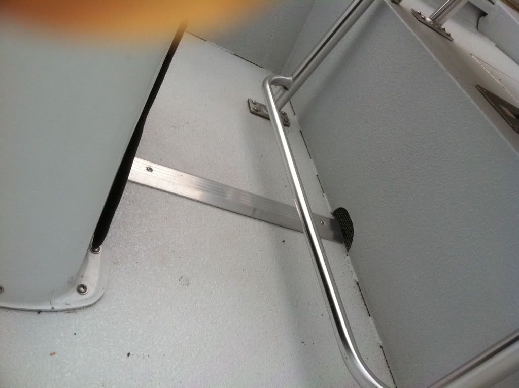

when i ran my lines for gps and the water pressure gauge i didnt have anymore room in the tubes that run all wires hoses etc .. so i bought a low boy threshold with s.s. screws and ran them through there also you can see the big drain hole on the floor had a problem of crabs and leaves getting back there so i put a heavy duty piece of s.s. mesh wire there in the hole from the back
