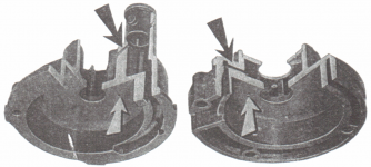

no gasket on the gear case housing just remove 4 bolts and drop it to unbolt the water pump housing for the replacement impeller
slide the new impeller down the shaft don't loose the small key & reinstall it
check closely the impeller housing has 2 VERY small holes... see pic. clean them out
slide the impeller housing over the impeller while rotating the shaft clockwise ...looking down the fins will bend in and then just bolt it up.
(apply a small dab of grease/oil on the impeller fin tips or around the housing inner wall)
query UTUBEs lots of videos to help out
line up the water tube and do not crush the rubber fitting on the pump housing .
