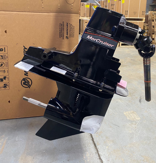

New alpha gen 2 drives $3200 US…https://www.michiganmotorz.com/mercruiser-alpha-one-gen-2-outdrive
same two sites sell SEI as well
