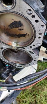

I don't like this picture one bit. Warm SB bank. Rebuilt powerhead, seriously?

In your picture, the oring looks stretched and there is no silicone around the water ports. Did you clean the remnants of it? Are the Orings correct for the engine?

Silicone was mostly stuck to the heads. O-rings - no idea, but since the rebuilders put silicone where manual tells them not to - I wouldn't be surprised. I'll have to see what happens with new O-rings, thermostat seal, and thermostats/springs.
I am more concerned about mayo in the cylinder, and looks like a bit of corrosion, too.

Compression leaking to the water jacket will cause overheat. You might check the head for warpage as well.

The service manual for my motor says grease on the orings, silicone around the water ports, when installing the cylinder head.
Yep. That's the part they apparently never read.
Never replaced thermostat seals, it looks like, either.

After the break-in period, I began running the engine under loads approaching normal. Additional symptoms (described above) appeared, eventually leading to a teardown. What I found was disappointing, to put it mildly.
  1. I have no idea whether the combustion chamber O-rings were replaced, but someone had applied silicone sealant to them. My suspicion is that they were reused.
  2. The thermostat seals clearly were not replaced. The amount of scale buildup is not consistent with an engine having fewer than 20 hours of operation. Here again, silicone sealant appears to have been used as a substitute.
  3. The thermostats themselves appear used rather than recently replaced.
  4. The cylinders show no obvious evidence of a fresh hone. There are traces of what appear to be original honing marks, but the overall glazing and wear pattern look much more consistent with a several-hundred-hour engine than with a freshly rebuilt one.
  5. Both cylinder heads showed evidence of water intrusion, including water/oil emulsion in the combustion chambers, consistent with leaking head seals.
  6. At this point, I am almost afraid to find out what the crankcase looks like.
Based on what I found, my impression is that this powerhead received little more than cosmetic attention rather than a comprehensive rebuild. I obviously cannot say exactly what work was - or was not - performed internally, but what I observed does not match my expectations of a professionally remanufactured powerhead.
The good news is that replacing the thermostat seals, combustion chamber O-rings, thermostats, and properly resealing the water passages appears to have resolved most of the issues. Both banks now warm up consistently, smoke has dropped to believable two-stroke levels, cold starts have improved dramatically, and so far there have been no more oil/water loogies.
